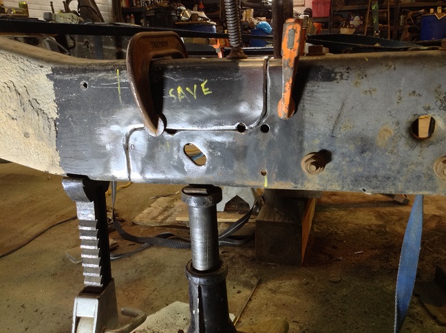

I woke up feeling happy that the frame cutting went smoothly after lots of measuring yesterday. I am looking forward to dialing it in some more today.

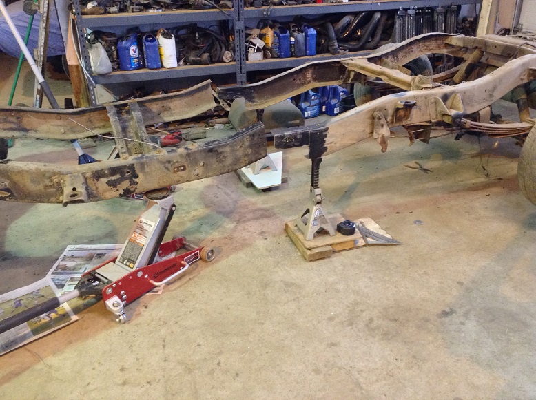

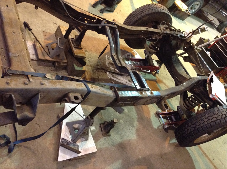

frame pix
Attached Thumbnails 2wd 12v poptop Ramcharger-framepix-1-.jpg   2wd 12v poptop Ramcharger-framepix-2-.jpg   2wd 12v poptop Ramcharger-framepix-3-.jpg   2wd 12v poptop Ramcharger-framepix-4-.jpg   2wd 12v poptop Ramcharger-framepix-5-.jpg

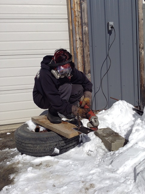

Charlotte helped me cut out a few fish plates for the inside of the frame to go over the cuts.
I helped her use a tape measure and speed square to mark them out with a paint pen from the left over 1/2 ton frame. We then got out the Saw-Z-All and grinder to make them. She then ground down all the edges to help with welding them in.
I will do a final grind on the frame cuts shortly before we go to a birthday party this evening.
If I am still on fire tonight we can get it clamped / squared back up to be ready for welding it this week.

It was all squared up and clamped down last night.
I polished all the paint and oil off the weld area with a wire wheel on my cordless drill so the weld area is nice and clean.
We measured off many points on the frame and I am happy with the the results.
It will get welded up tomorrow.

It was a late night in the shop yesterday. The frame is all welded up and looks awesome. I even hit it with a little primer and paint where I had ground it down to fresh metal for a good weld. One of the front cab mount brackets was also swapped out for one that was not all hogged out off the old RC frame.
I will test fit the tub back on it tonight after work with Walter to see how well it lines up.
I also had sometime yesterday to start prepping the '94 motor. I got the clutch fan off so I can access the KDP and front seal. I will also install a bigger harmonic balancer off a later 12V. I removed the A/C compressor and swapped out the motor mounts for the 1st gen style.

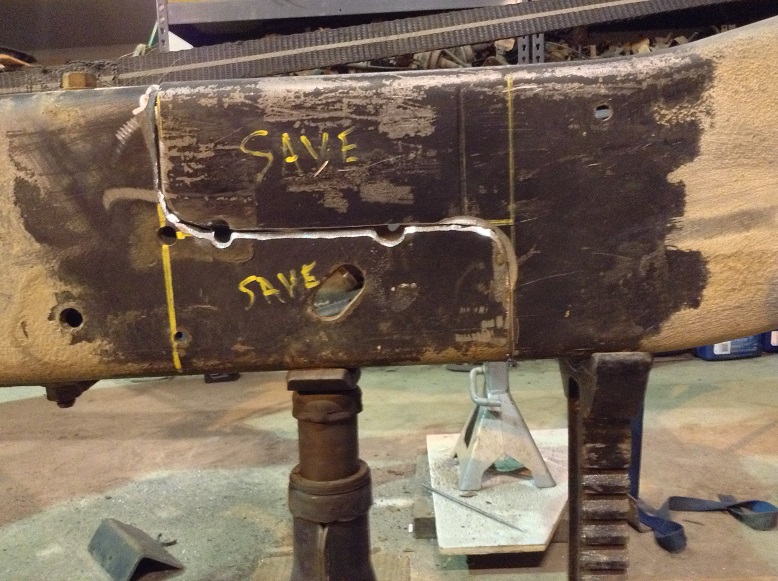

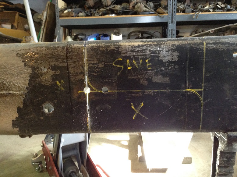

Posts: 6,837
Photos from the mid point of the frame work
Attached Thumbnails 2wd 12v poptop Ramcharger-fishplating-1-.jpg   2wd 12v poptop Ramcharger-fishplating-2-.jpg   2wd 12v poptop Ramcharger-fishplating-3-.jpg   2wd 12v poptop Ramcharger-fishplating-4-.jpg   2wd 12v poptop Ramcharger-fishplating-5-.jpg
Old Mar 24, 2018 | 09:14 AM
  #115
Posts: 7,247
Likes: 2,874
Thanks for posting pictures T-man!
She was a little tentative at using the Saw-Z-all to cut the plates out of the old frame, but I held the saw steady while she operated it to make sure it was safe. As you can see in the picture she had boots on along with ear / eye / hand protection and a dust mask.
She had fun while we made those fish plates.
It gives her some ground to stand on when she asks to drive it in a year or two..
