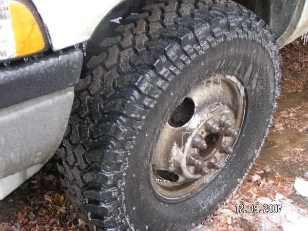

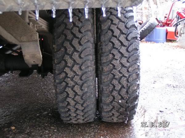

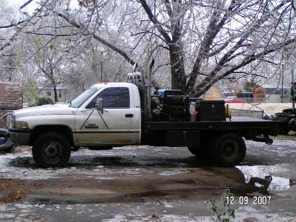

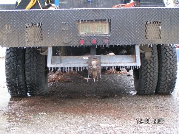

Old Dec 9, 2007 | 10:26 PM
bandit1trucking's Avatar
Posts: 29
Here are some pics of the 255/85 BFG mud terrains on my truck.

Old Dec 9, 2007 | 10:41 PM
Bookshelf's Avatar
Posts: 375
From: Chicago Suburbs, IL
Originally Posted by archer2
Here's a 255/85/16 next to a BFG 285/75/16. I found that in the "slush ruts" the BFG's are prone to uncommanded lane changinghttps://www.dieseltruckresource.com/forums/images/smilies/shocked.gif
, therefore I use with the skinnier MT's in the winter.
https://www.dieseltruckresource.com/...1&d=1196699552
IM000360.jpgFG 285/7https://www.dieseltruckresource.com/forums/attachment.php?attachmentid=17406&stc=1&d=11966996 34
IM000361.jpg5/16
Thats a BFG 255/85 mud terrain? The tread looks different than the tires below on the dually.
