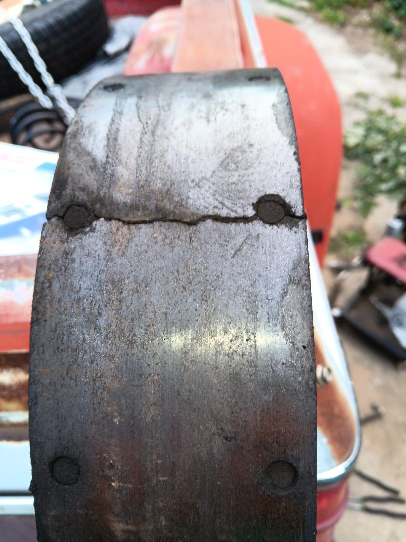

My truck is down. Went to do rear brakes. I have put 47K on this truck since I bought it. Passenger side had the bearing torqued too tight. It damaged the outer bearing. Brake pad cracked due to heat. Driver side had the inner seal leaking. Turned the pads into mush. All the parts will be here by tomorrow. Rain is predicted for the next 10 days. I guess our drought is going to be over. Of course we are working outside.Truck is 50mi away in Nashville. Did I mention I need to build a shop? Bearings will be here tomorrow. I bought a Mag-Hytec diff cover. Ordered Hotshot Secret 85-140 Severe Duty oil. Ordered 1 gal. Enough for the stock cover. Not for the Hytec. It takes 6 or 6.5qts. I ordered the second one on Tuesday. It hasn't shipped yet. Might top it off with regular gear oil and the factory cover.
Not sure about the friction additive. Some people are telling me it might make the thing slip if it has too many miles on it............
