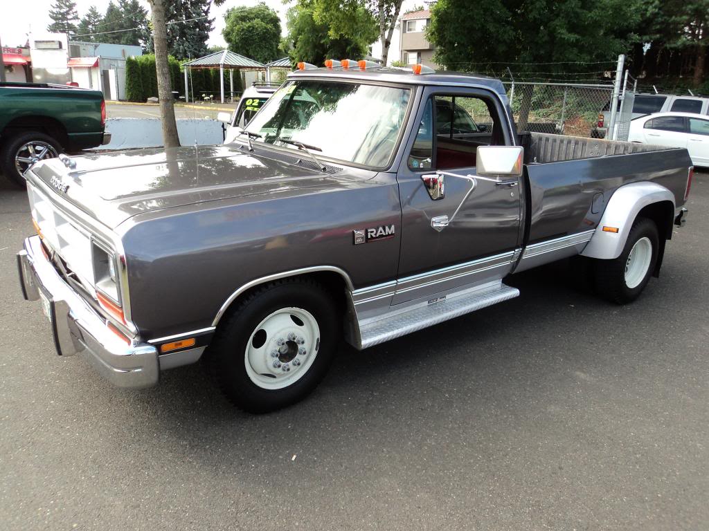

This is the 89.

Yup, I would do the 89. The pic is nice. Look at the seat, pedals, floormat. That whole picture says low use. That means alot in my book.

I think I will go for the 89. Is 6K a reasonable price for the truck. I would like to get it lower but I don't know how much they will budge.
Here are some more photos.

wow that is clean! I've been tracking 1st gens on ebay for awhile now as I'm thinking of selling mine. I've seen quite a few W250 5spds get bid up $7-11k. Even the 2wds fair pretty well. These trucks are holding value, and that one looks stellar in the pics you've posted. You won't find 2nd gen that clean for less than twice the money.
Only negative to is IMO is the regular cab dually configuration is less desirable, would be great if it was a club cab. I would definitely haggle with him, but $6k looks like it buys a lot of truck there.

Just walk around it and point out stuff you see that will take away from the value. I see the trim is missing the black inserts, and the lower grill valence is bent. Just say things like that and ask questions like, how did that get bent? Is there any more damage? stuff like that. See what they will talk down. In the pics it seems well cared for, and not abused. Also make sure the tamper caps are on the pump. A stock truck is worth more then a tuned truck any day of the week. I could have all 3 of my trucks burned to the ground in an hour, but in stock form they can run flat out 24/7.
