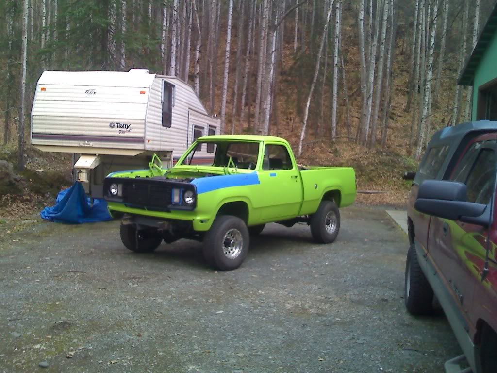

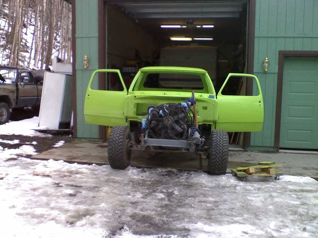

As for if it will fit....
Yeah it will.
Should be a bolt in for you. And you need to get rid of that 44 CAD axle. Go for a D60...even if you use a full time setup.
Good luck.
