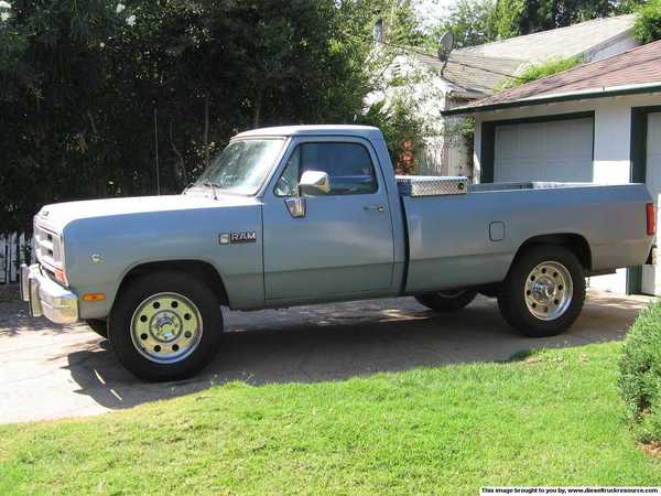

Rickson 19.5" wheels with 245/70 R19.5 Michelin XZT on 1989 D250. Only height mod from stock was M00g 7226S springs and Daystar Coil Spring Spacers. Nothing on Rear. Check my gallery for two other pics of this rig setup with the rickson wheels.

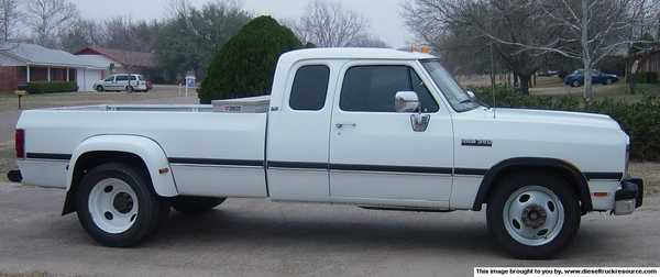

Old Sep 1, 2009 | 08:44 PM
dig'umz's Avatar
Posts: 171
From: lorena TX
They ride rough and swallow horsepower, but darn they look good.

How tall are those tires?
Old Sep 1, 2009 | 10:18 PM
PapeCAT's Avatar
Posts: 2,658
Likes: 85
those look like 225/70R19.5 which are the same overall diameter as stock size wheels and tires 235/85 R16.
