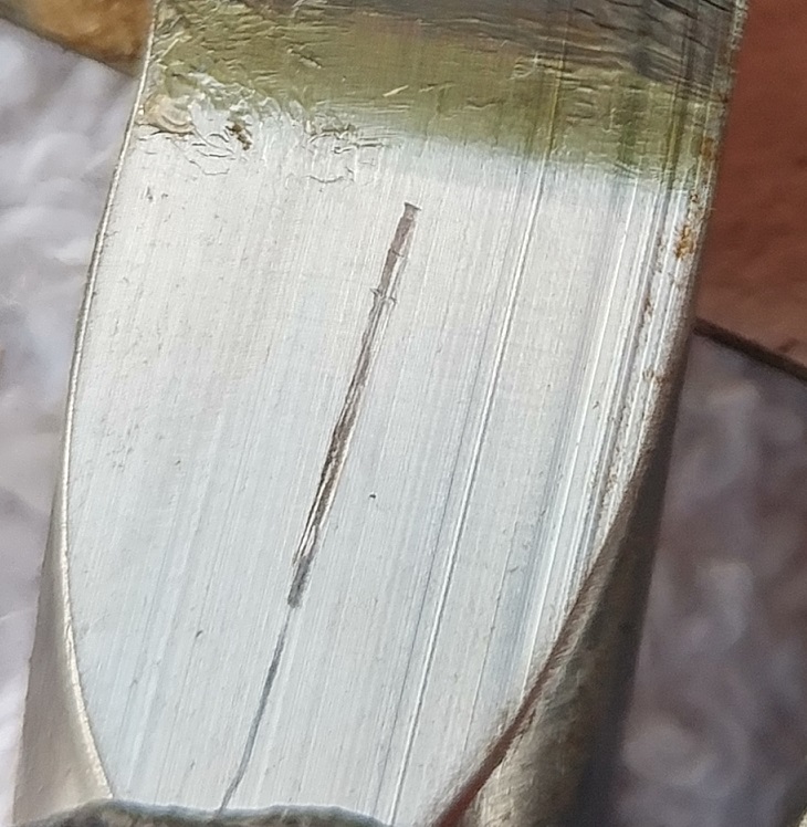

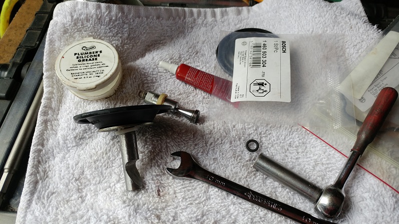

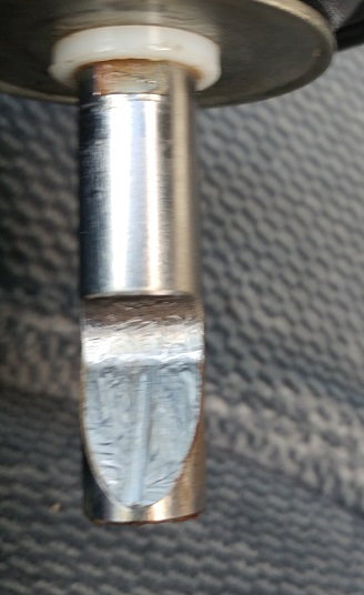

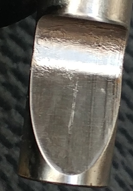

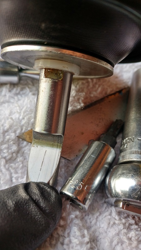

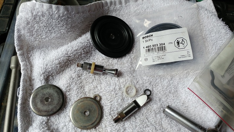

So, during the summer, I installed my new16CM housing, turbo housing, wheel, and set the factory pin to it's deepest setting.
Truck runs great.
Wanted to drive it that way to be able to gauge any improvements the new pin would provide, once I put it in. Well, 4 months have gone by, and today, I decided to install my new GD Pin. Put it all together, with a new Bosch bellows on the top of the pin, and drove it around.
Runs great. Minimal smoke during acceleration. Seems a bit more peppy with the new pin.
So, after 15 minutes of going up and down the highway, I get back home and pull the pin to see the witness marks in the silicone grease to be able to gauge how deep the pin is going into the chamfer, to see if I'm getting the maximum power from the pin. Ran a little short, but still in there. I go to regrease the chamfer area, and I notice that the pin is scratched. I run my finger nail on there, and it's slightly grooved. I cleaned up the pin and found that the rod that comes out of the VE pump actually scored the chamfered surface of the pin. I called GD and spoke with Adam. He asked me to send him pictures, of which you see here.
I told him I'm going to drive it about for a while and see if it continues. even though he said that they "have the pins hardened after cutting", it seems as though (to me) it shouldn't be scratched or grooved at all.
I guess this is why you don't want to make your own pin unless you know a metallurgist who can set the pin to the proper rockwell hardness scale.
UGH.
BTW, if this remains an issue, they said they will replace the pin for me under their warranty.

looks pretty soft to me. maybe you got one that missed getting hardened. the machined surface looks pretty rough to have been ground.

Who made the pin? Also, you can run the pin without the nylon spacer or trim it down some if you think you really need it. I discarded mine when I first ran an M&H M2 on the 91.

I don't know. It came in the kit from Gillette Diesel as a matched set to the turbo upgrade I did.. The pitch / profile is nearly perfect, as my truck really runs great. I'll drive it around a bit, and once I get my hands on the bosch reseal kit, I'll dive into it again.

a few of the other aftermarket pins i've seen have scored like that also. the stock pin is the only one i've found that doesn't, atleast not as quickly.
i would remove the white plastic washer to ensure you're getting to the deepest part of the pin. most aftermarket pins are designed to run without it.
any increase in max boost?

Haven't really gone all out on it, but previously I was maxi g out at 21 psi or so, give or take. Drive it yesterday, and not all out, I was up over 23 . so yes. I'd say it's increased. Regarding the spacer, I installed the one that came with the pin. Its shorter than stock spacer. When I take it all apart again, I'll leave it out. It will allow travel to the deepest sector of the pin, of which it's currently restricted from reaching by it being there.
