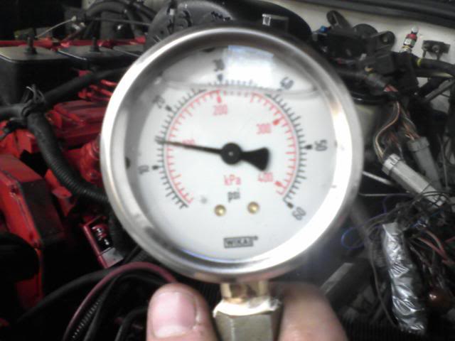

my original OF valve had a broken spring in it when I got the engine. that why my FP was under 15 at idle. this was just a stocker '95 engine. dont take the small nut off the overflowvalve thats where the spring and ball are. pull the whole thing out. there 2 copper seal rings one on each side of the line. don't loose them is what infidel is talking about with putting a rag underneath before you pull the valve.

Symptoms of low fuel pressure most often caused by a bad OF valve are:
Lack of power
Poor fuel mileage
Sputtering or missing at high rpms or under load
White smoke
