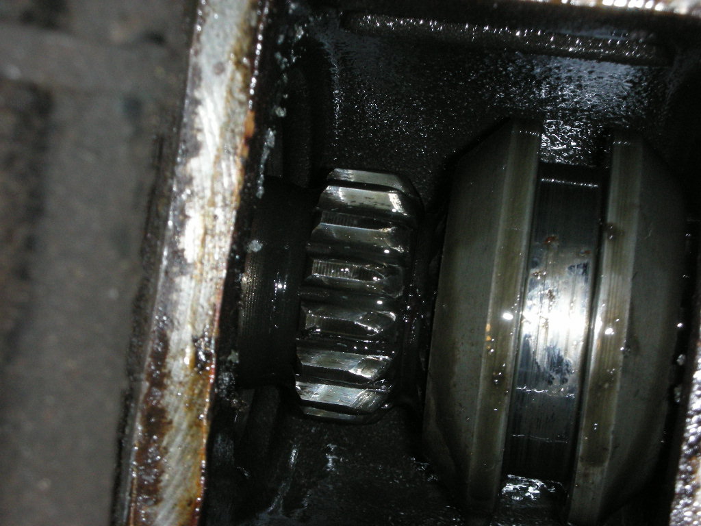

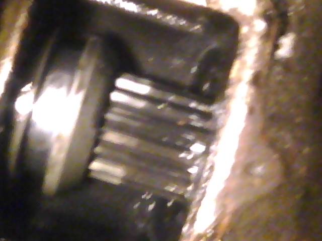

Here's a couple pics, the splines look pretty good, does'nt look like its been sliding back and forth, (tearing the splines up) no really wear on the ends .

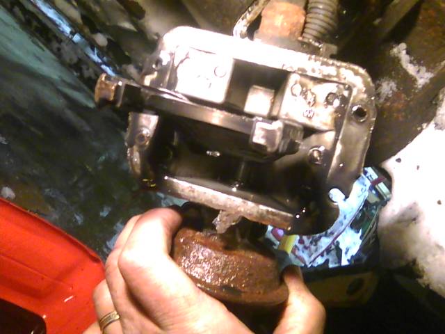

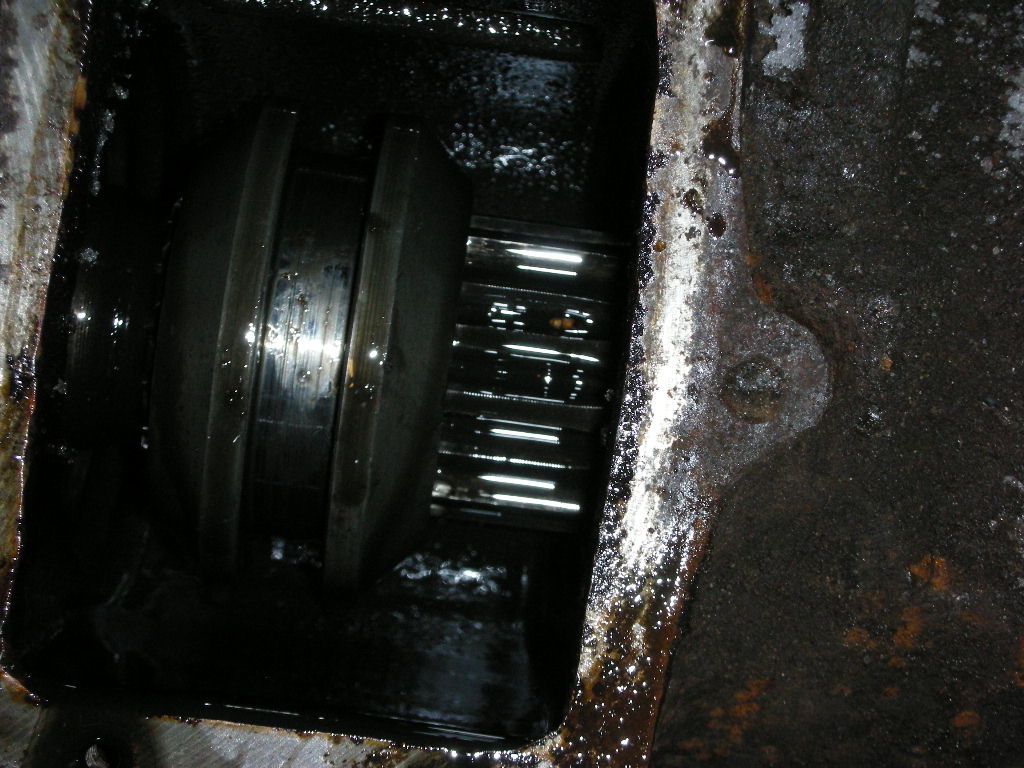

some more pics
Attached Thumbnails weird sound, while plowing, U-joint??-1214101543b.jpg   weird sound, while plowing, U-joint??-dscn1794.jpg   weird sound, while plowing, U-joint??-dscn1795.jpg

Hmmm, guess its not the CAD then.. maybe a ujoint in the front shaft, or axle?
Not much else that could make a bang like that, up front.
