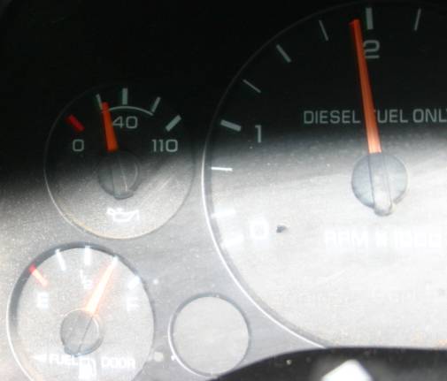

Haven't had a chance to check any oil pressure with a separate gauge yet, but here is a pic of what I saw as I rode down the highway. Quite unnerving. But turn off the cruise control and the pressure goes back to 40 as the RPMs go down.
Chris

The electrical gauge stays right around 40 psi ALL the time. Since I have had the mechanical gauge connected the electrical gauge has not dropped down the the level as pictured above.
I understand that there is a plunger or something in the oil filter housing that may limit the oil pressure because of build up in the regulator passge, but in this case I have great fuel pressure but a gauge that reads wrong, sometimes worse than others.
Do I need a sending unit?
Thanks,
Chris

Mine did that and it was a bad sender. Mine was actually leaking a small amount of oil and when the mechanic removed it the thing fell apart. That would've made a nice streak on the highway if it had let go on the road. Now back to normal pressure. Just like the owners manual shows, slightly above 40psi. most of the time.
Spend $30
Mine did about the same thing a few weeks ago. $30 +/- for a new unit, and viola!
We be back on the road with a pressure reading that is steady as a rock, more or less.
