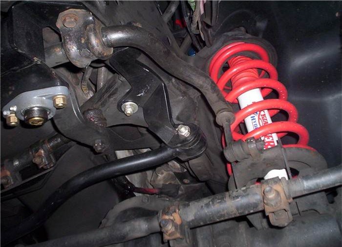

I run the Soild Steel Third Generation Kit on mine.Its has made the truck drive like it should have from Ma Mopars factory long ago.You will not go wrong with any of their products.....Andy
Here is a shot showing the 3rd gen Trac Bar and the DSS Brace on the driver side of the truck.
