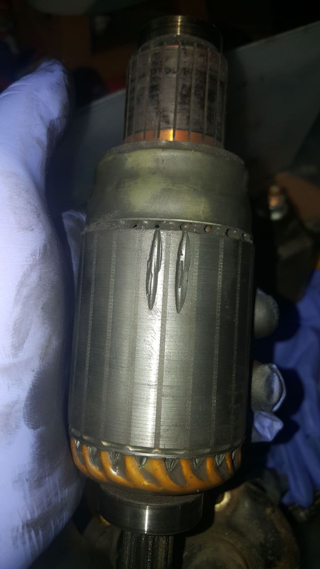

I just took apart the starter for my 94 cummins with 120k on it. The starter is the factory denso and it stopped working (had to smack it to start) and while taking it apart the armeture had these markings. I know nothing about what is good or bad but i want soneone who knows a thing or 2 help me. It smells burnt also. Please help if you know any info and also where i should buy a new armeture or if i should just get a new starter....

balance

What John said.
Looks good to me, the starting issue was with your starter contacts, put in the oversized ones Larry B's sells........

Thanks guys for helpin. I just cleaned the armeture and the housing. They were pretty nasty. But after that the starter worked perfect. Starts strong and no issues (so far)

By any chance, did you happen to count the number of commutator segments on that armature? If I did a current ramp on my starter and knew the number of segments, I could determine starter RPM.
