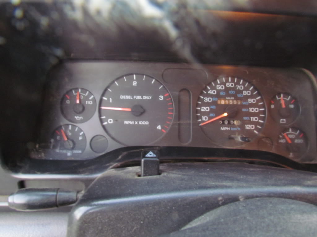

Original poster- what does your truck idle at? It should be 750 or so. If it is lower than that on mine, then it needs pedal to start. A tiny adjustment makes a difference. I'd suspect that yours is idling too low.
Old Oct 12, 2011 | 08:35 PM
TheNeckasaurus's Avatar
Joined: May 2010
Posts: 234
From: Fresno
