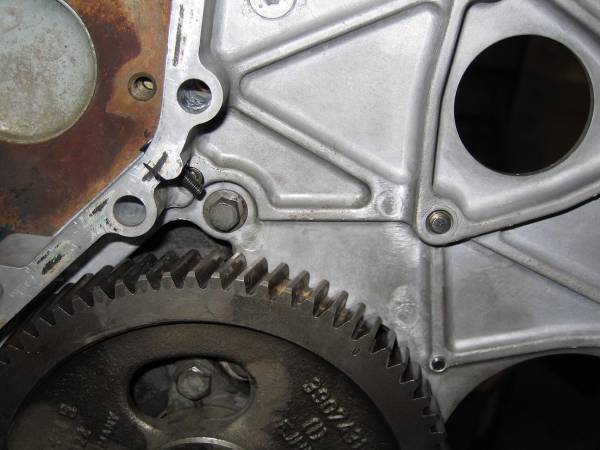

Someone else did this and I'm going to do the same, I think it is the best.

That pin fix is neat.
I simply used some heavy coat-hanger wire. Works just fine.
Some using a punch, simply dimple the metal of the case around the pin effectively locking it in place.
-> While you're in there, be sure to check and re-torque the case-to-block bolts.
That works well. But if the pin is out you will have to pull the cover anyway. And it seems that most of them are out at least a little. Mine certianly was.
And I have wondered if the coathanger wire really is stiff enough.
