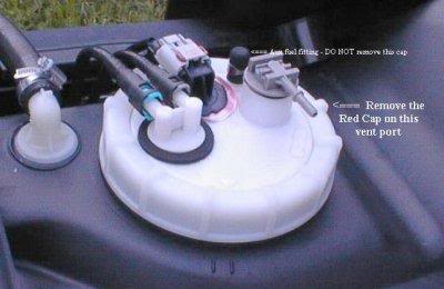

Earlier tank modules had metal supply and return lines that could rust away and leak.
That's when you need a Drawstraw.
I think by '98 Dodge realized their mistake and the lines are plastic.
