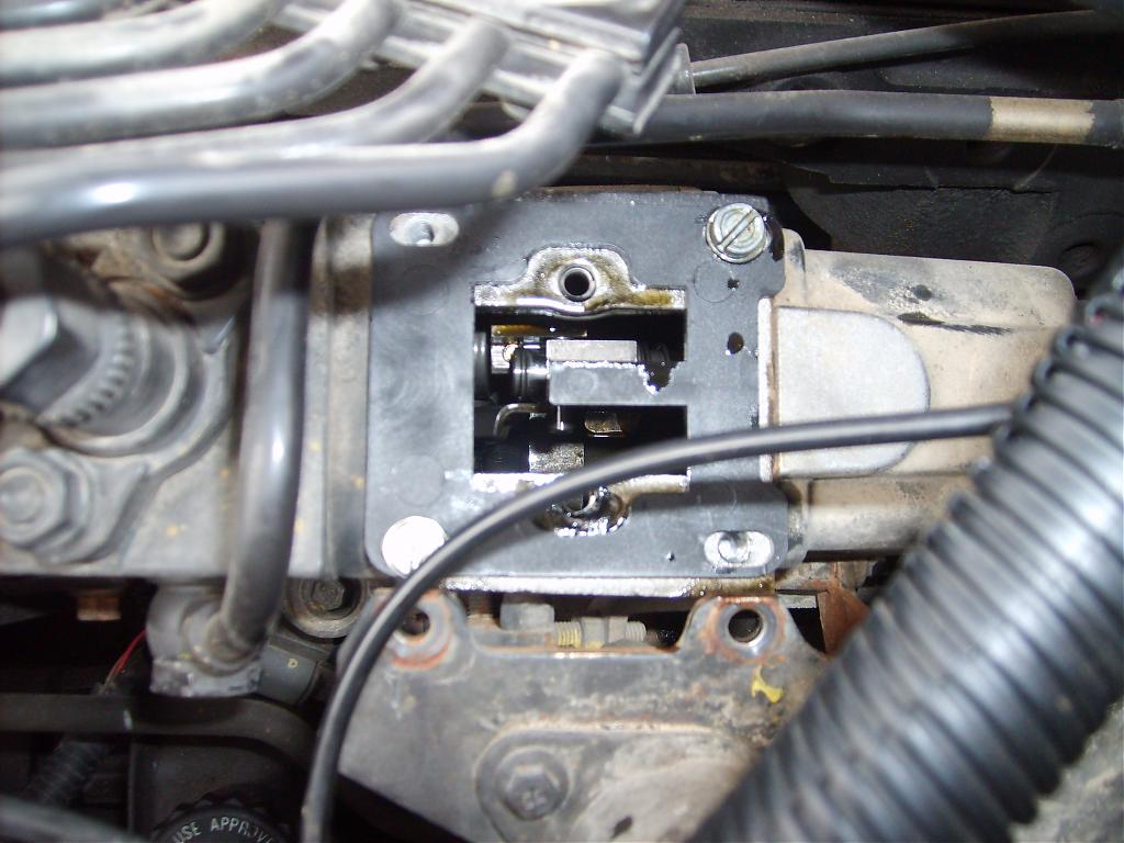

maybe this is it? i couldn't tell due to the small size of the pictures while looking through them on here. i guess i am too lazy to open another program to find the right one.
Attached Thumbnails Does anyone have a picture of the stock fuel plate position-s5000483.jpg

Old Aug 10, 2007 | 11:23 AM
cheapskate's Avatar
Posts: 167
From: lewis center, oh
nope, thats not the right one, that is of the tst plate "guide", with the plate removed. lets try another. oh, well this one is of the plate in the stock position, but the plate guide thingy is in the way, so you can't really see much. sorry
Attached Thumbnails Does anyone have a picture of the stock fuel plate position-s5000486.jpg

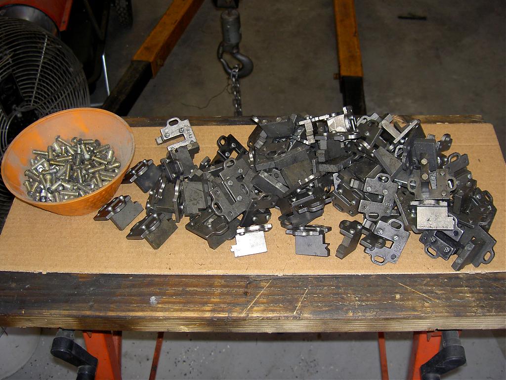

Stock fuel plates
This is just some of the fuel plates I have removed
Attached Thumbnails Does anyone have a picture of the stock fuel plate position-stock-fuel-plates.jpg

got any of them laying around you want to get rid of??? thats a lot of plates
