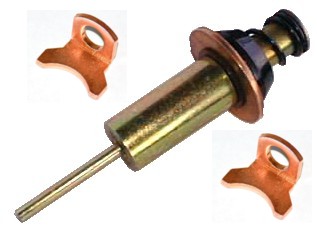

Good points have been made. You can get better starter contacts and other starter problem stuff here and look around the site for links to good troubleshoot info on your problem:
http://www.fostertruck.com/dodge/default.htm

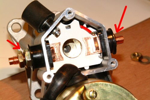

Go to that web site I gave you earlier (and posted here again) for pics and description of how to do starter contacts:
http://www.fostertruck.com/contacts_install.htm
Take a look. Its pretty easy to remove starter. I've done it. The space is a little cramped but crawl under drivers side behind the wheel and look up at engine above oil pan at rear. Be sure to disconnect both batteries at either gnd or positive post will do. Here is a pic from that site of the starter and what it looks like in the contact area:
