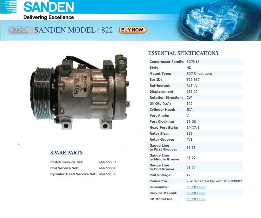

I've found an alternate Air Conditioning pump for the 12 valve that has threaded ports for custom installations. I has the same asymmetrical mounting pattern as the factory pump. I couldn't find a threaded port adapter for the Dodge AC pump, came up with this:
Sanden SD7H15 model 4822
