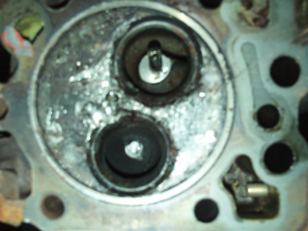

Took the head off one of the engines.
This thing is trashed, how do you lose both valves? The area between the valve seats is damaged a little but most damage is to the seats themselves. Any chance this head can be repaired (cheaper than buying a new one)?

Old Mar 1, 2008 | 08:41 PM
Troutstrannysvc's Avatar
Posts: 285
wow... FUBAR!
Crush test the main and rod cap bearings for oil clearance
Old Mar 1, 2008 | 10:36 PM
kawi600's Avatar
Posts: 2,910
From: Boston, mASS
OMG.. what a mess.
You can get fully loaded cummins 6bt heads for cheap out there if you look. I think puredieselpower.com was the cheapest IVe seen so far. 570$ if I remember right..
