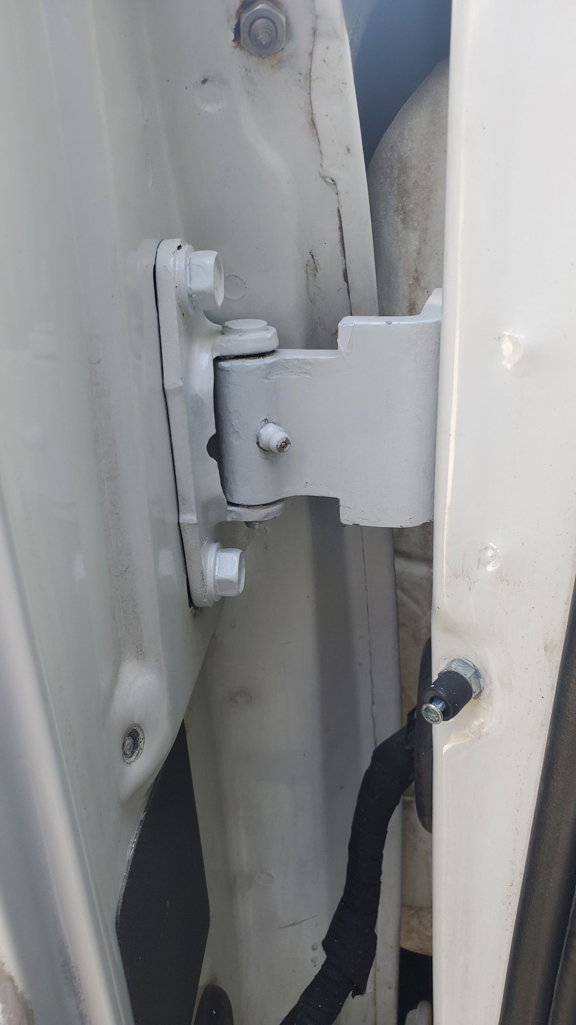

You can see the zerk. The bushings in the kit were a little loose. Loctite 620 for bushings was used. To get access the drivers air duct has to come out. A short screw driver works. When the duct was out. I ground the rivets off the bracket and added #10 floating nut plates. This way i could install the bracket and put the an525 screws inside the duct. Easier.. but not a must. Upper hinge r&r wasn't horrible.
