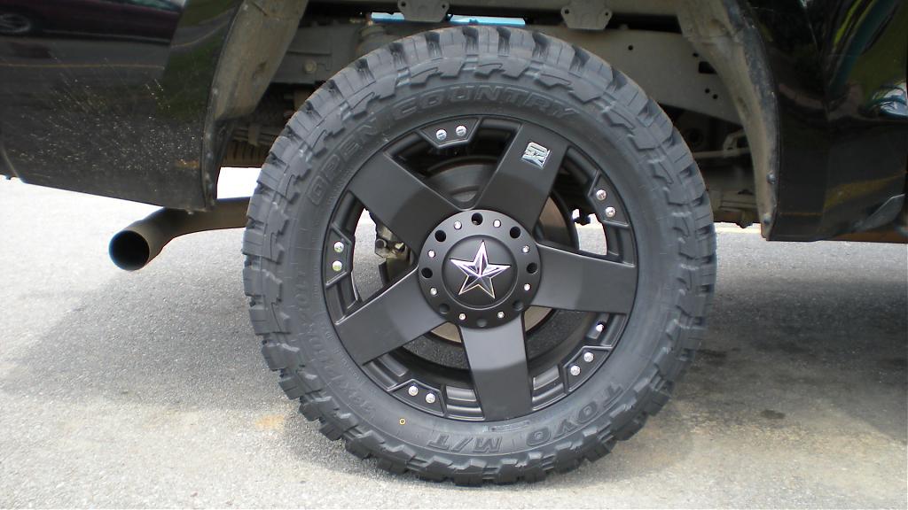

Just put to Toyos mt's pn my wifes truck. That is a great looking tire.
