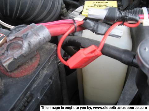

This is a pic of the wire and fuse holder I connected at the battery. When the camper is not loaded or the truck is parked, I remove the fuse.

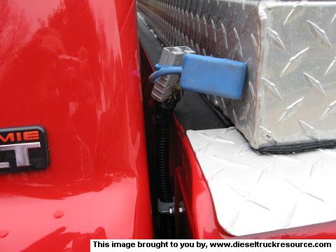

This is the electric welder cable type connector I put on it. If I'm going to have the truck/camper parked for awhile, I just unplug the connector since it's just outside the truck door.
