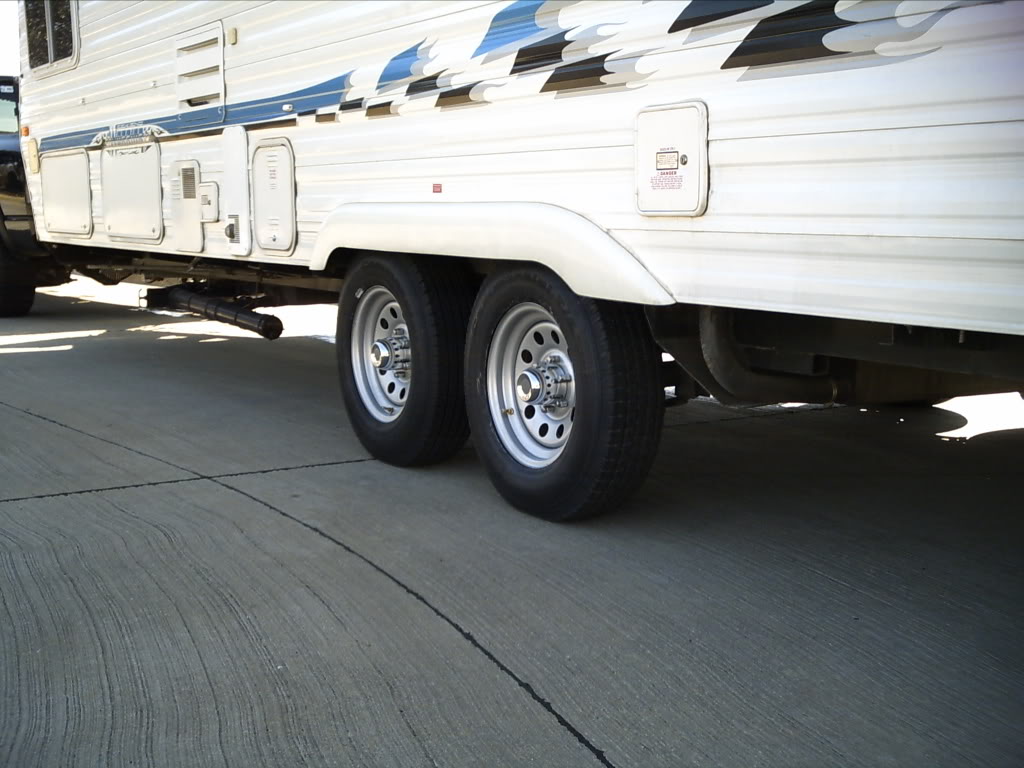

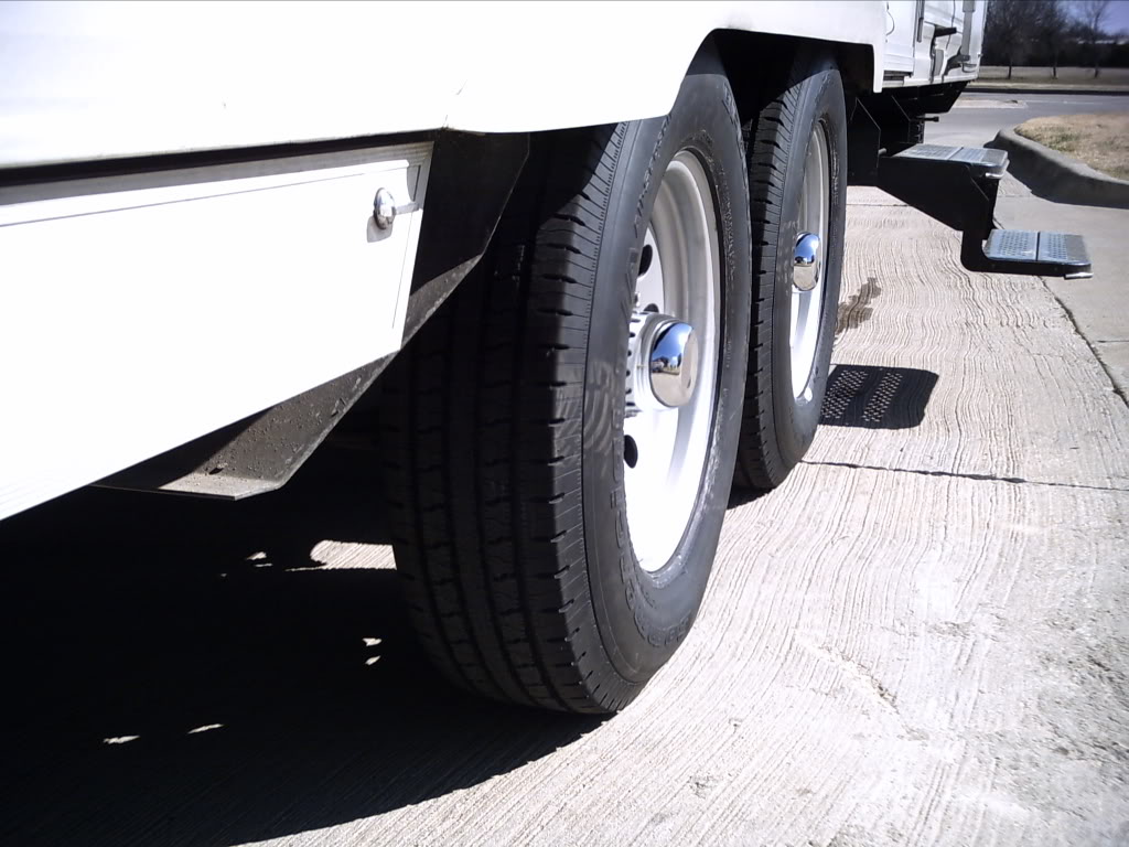

I upgraded to 16'' rims and BF Goodrich Commercial LT tires on my Toyhauler this past February. Bought 5 of each from Discount Tire. Great decision, in my opinion. I feel very confident now going anywhere in any temp....even at full load.
