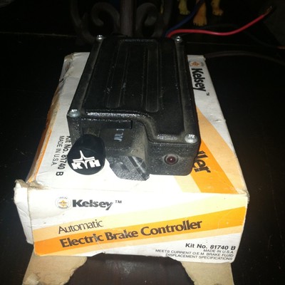

Thirty bucks on eBay, 6 bucks for the adapter. Only thing it doesn't do that MB does is compensate for electrical fade. If the brake application is long and slow, there's plenty of time to reach down and augment the braking with my thumb. For 320 bucks, I think I can manage that.
Life expectancy on these 81740 series controllers is approximately forever.

Sweet! New old stock!
Other than having to run a line inside, I would rather have that over any current offering!
