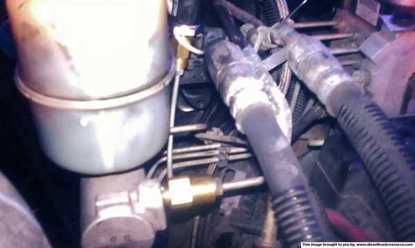

Just curious where people have tied their Maxbrake sensor into the brake lines on a 2nd gen Ram.
It looks I have two lines coming out of the master cylinder, going to a connection block, then going into the ABS module. Wheres the best place to tap into the lines? I want to get this right the first time, and not risk kinking a line anywhere.

I put mine on the forward line. So far so good!

The fitting is a T that goes right into the master cylinder. If you call MaxBrake with the application, they can supply you with the fitting. The original line will easily go where it needs to.

I installed mine on the front brake line and then bent the tubing to go back and use a tystrap it fast to the back line. It has been good now for three years.I had a friend hold the brakes and bled the maxbrake fitting on the end. Works great.

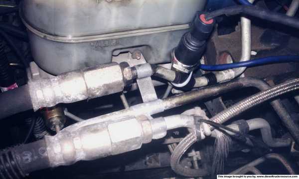

The install was easy. Think the hardest part was getting the inside connector for the sensor through the fire wall. The OEM brake lines have more flex in them than they appear to.
My T fitting when tightened, had the pressure port facing to the rear and downward. So I bent the sensor line into a U shape with the sensor oriented vertically and secured to one of the hydro booster lines.
Came up with a neat trick to bleed the lines that I'd like to pass along. I used a marinade injector, with no needle, to draw some of the fluid from the reservoir. I then loosened the T fitting and "injected" brake fluid from the sensor end, towards the T fitting. I even prefilled the sensor too. I only had to bleed the sensor with the brake pedal after connecting it since a little leaked out when I put it on.
