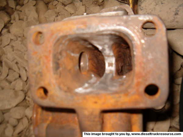

Hmmm, I'm not at all versed on the new-eras, but my weenie lil' 1st gen will blow a hole in my 40psi boost gauge with the 18.5 on so my guess is that you will not be able to control boost with the new sticks. Mid to high 30's is already pushing the MAP of the 35. Here's what I did to my 12 to keep from overcoming the 'gate:
compared to the 18.5:
I also enlarged the wastegate hole to nearly the diameter of the flapper. I can give her heck at 1600 rpms in 5th and boost jumps to 30 and sits there
Bottom line IMO: If you can control boost with a larger, non gated housing, run it, especially with an auto. But, with the fuel you're planning, I think you're going to need some sort of 'gate...
