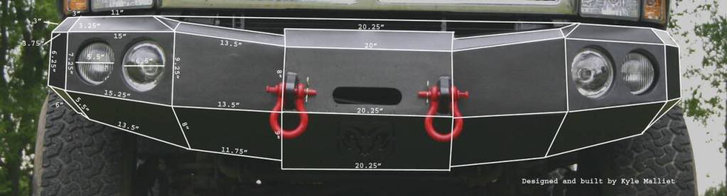

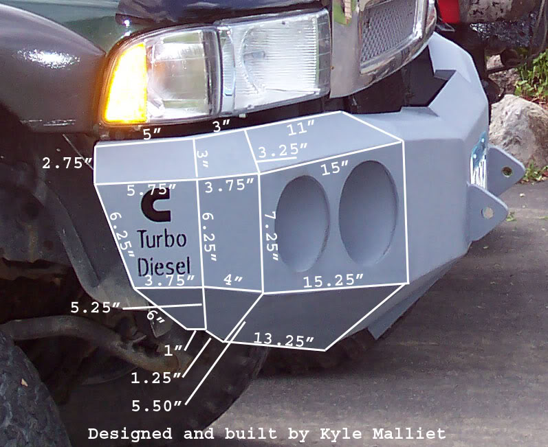

you talkin about these? i will be building mine this summer as well

Yes, thats it - was too busy last night to do this. Thanks.
