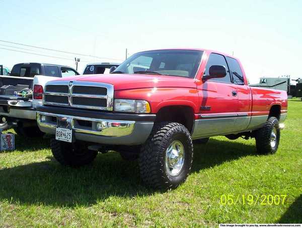

BTW our trucks are twins:

Love the truck we are almost twinkin lol!!!
