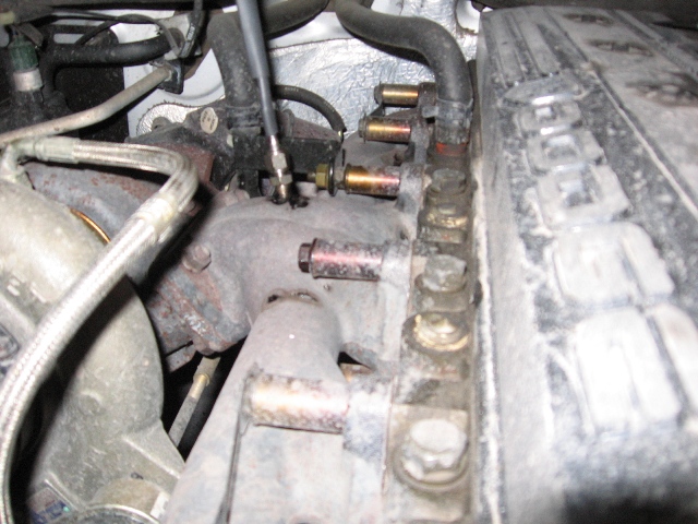

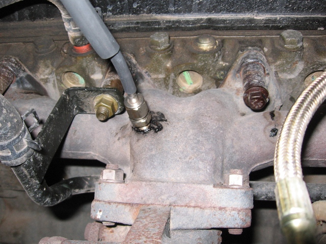

I just installed a DiPricol Pyrometer that i got from DPPI. I used the thermocouple that they supplied in their kit. I think that my gauge or something is messed up. the needle moves up and down quite a bit. if i get on it it will rise up to around 1000°F and as soon as i let off of it it will drop back down. Today while i was coming home from work( ~45mph 10 minute drive) it was sitting around 300° and then when i stopped at the light for a couple minutes or so, it dropped to ~150°. now i am thinking this is too low.
i have attached some pictures. to show where i tapped the manifold. i dont think the gauge is bad cause i just installed it last night. did i not put the thermocouple deep enough?
please help...

Install looks good #'s are not...I've never seen 150 even on cold mornings once it starts its 300+. Bad thermocouple? Take it out and put a heat gun on it and see how it responds. I have the couple in mid way into the manifold. held it next the manifold to estimate mid way and marked with piece of tape. Install and remove tape...
