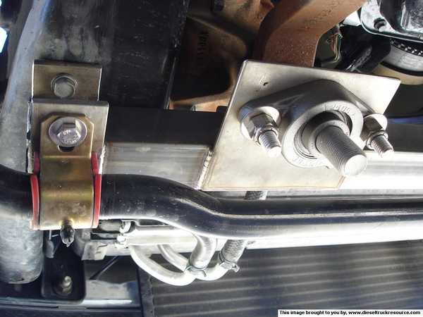

The steering stabilizer/sway bar drop mount combo I made was the single greatest improvement to the factory steering design.... and I installed a track bar drop mount to preserve the stock geometry: https://www.dieseltruckresource.com/...SSS_Large_.JPG |
Thanks! :)
I fabbed mine out of 304 SS - I hate RUST ! [coffee] |
