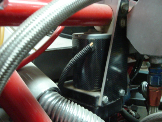

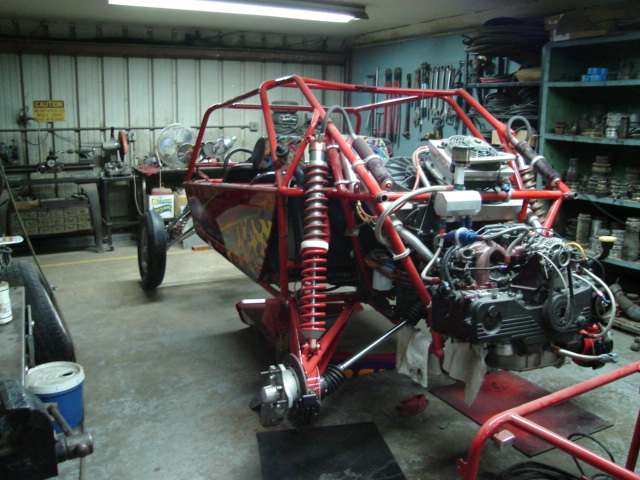

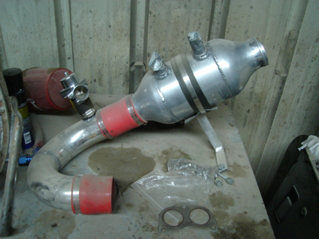

JPR Ram's Avatar
Posts: 1,820
From: My head lays down in Murrieta, but the day light hours are spent in San Diego, Ca.
Seems to me that spool up would be quicker. My buddy has a air to water after cooler on his sand buggy. He's running a 2.5 Suburu. He's pushing 500 pony's before the NOS.
The first photo is of the inline aftercooler. Second photo is of the electric water pump. The third and forth are of the aftercooler radiator, which sits above the main radiator. The the last is of the turbo.
His system was relatively cheap to build. So it is possible, in a larger scale of course.
Attached Thumbnails Liquid Cooled Intercooler-misc.-003.jpg   Liquid Cooled Intercooler-misc.-005.jpg   Liquid Cooled Intercooler-misc.-006.jpg   Liquid Cooled Intercooler-misc.-007.jpg   Liquid Cooled Intercooler-misc.-004.jpg
