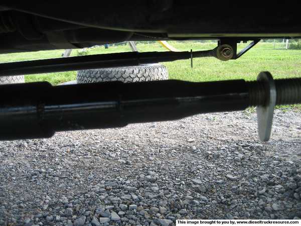

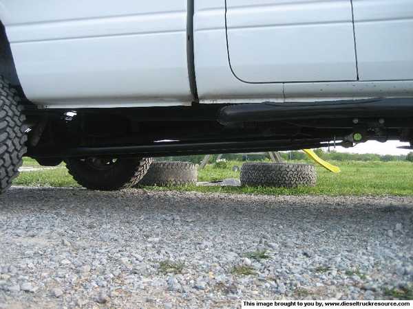

My new Sled Puller Bars!!

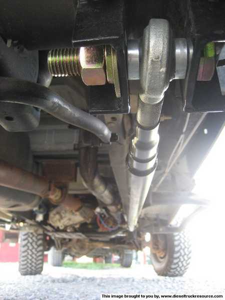

Bar to heim connection, beautiful Welds!!

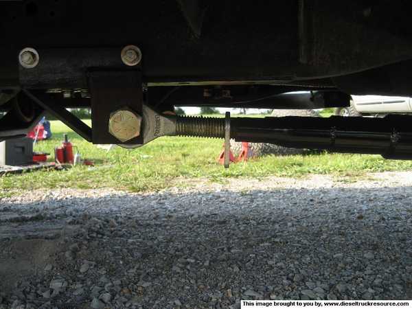

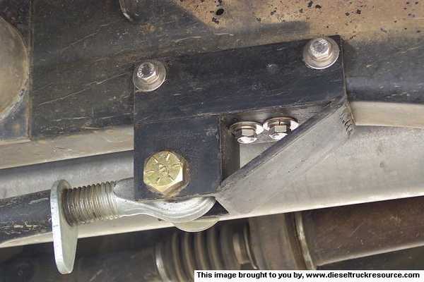

Front Bracket, all stainless hardware..

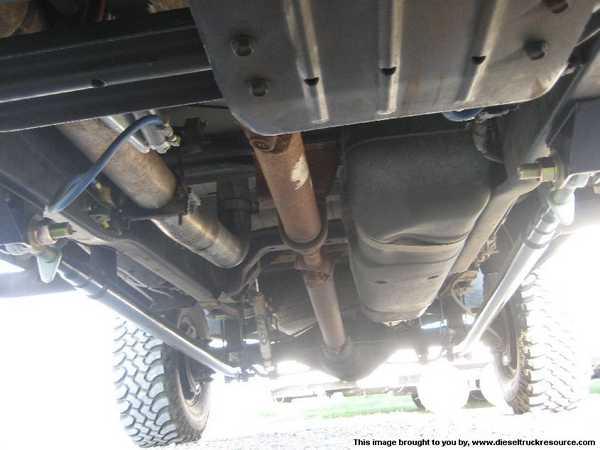

Rear to Front view/ Rear U-bolt bracket
Front to Rear
I love these bars!! Completely changes the driving experience in the truck
Pros:
Upon acceleration I no longer feel that squishy, squatting feeling resulting from the horrible axle wrap these trucks experience when put under load. Now when I roll on the coal I can literally feel the power going to the ground and not be wound up in the leafs!! The front end of the truck literally lifts upon hard acceleration!! The coolest dang feeling in the world!! If you have ever watched a truck without bars on a dyno you can watch the axle move forward and back under acceleration from the spring wrapping and unloading. My truck doesn't do it all all now, power goes straight to the rollers not the suspension!
What I like to call the cruise control clunk is eliminated... Such as when cruise control is in use and the engine is under load, normally if you were to hit the cancel button (say if approaching traffic) there would be a horrible driveline clunk resulting from the suspension unloading... Seeing that the suspension always has a bit of preload this issue is eliminated. I know in a standard when I used to get on the throttle hard and then have to release (for the next red light ) I would get the same driveline clunk that always made me cringe... No More!!
Probably one of the most surprising changes to me was the much better handling characteristics that the truck now has... Body roll have been reduced considerably!! I can send this 8k truck into corners like a little sports car the whole way!!! I love it, I love it!!
Bolt on installation means no welding on my frame, heim joints are huge no chance of breaking, stainless steel hardware means that these bars will look good for a long time!!
While towing the gooseneck this past weekend I noticed a huge reduction in body roll while going around corners loaded especially if I have to brake. Almost feels like I have training wheels back there!!
A huge pro for me was the decrease of spring wrap and clutch chatter associated with my extremely sticky clutch... Pre-traction bars my 2nd gear starts were very shaky bucking the truck around as the springs loaded and unloaded. The bars while not completely eliminating the issue dramatically improved it. The most noticeable improvement was noticed while getting my 14k gooseneck moving from a stop. Much Smoother!!
Middle Ground: Well I think that ride may be slightly stiffer than normal, but could just be my imagination as the truck rides like crap anyway!! However the truck is noticeably smoother on repetitive bumps in the road... Such as washboard roads or roads that have repeating joints that usually cause the truck to bounce all over the place because of the harmonics in the suspension that build on each other bucking the truck around, this is a much welcome improvement
Cons: I let you know when I find one
I am overall extremely pleased with these bars a huge thanks goes out to XLR8R for making these for me. Definitely one of the best mods done to the truck thus far, 2nd to twins of course!!
