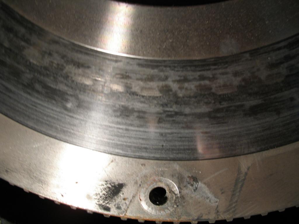

After the warranty replacement of my Con FE on a defective center section, I had a chance to inspect the flywheel, obviously, after about 80,000 miles on the clutch. Resurfacing the flywheel was a breeze as the wear was less than about 0.010 that they took off in the grind at the machine shop. I don't worry much about it at all anymore. It is grabby, but I expected that. It holds though even when playing around.
I added a photo of the flywheel when I pulled the clutch.
