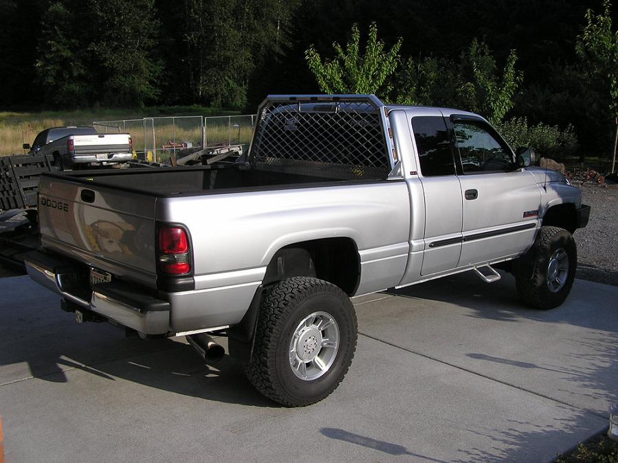

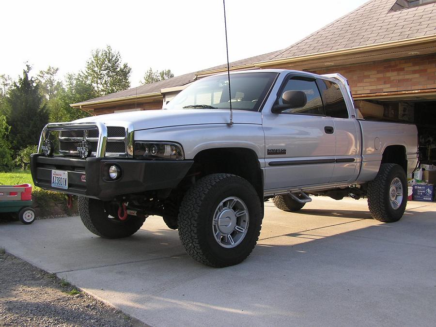

Here's a few pics of mine...
Attached Thumbnails H2 Wheels (Thanks DTR)-dougs-truck-001.jpg   H2 Wheels (Thanks DTR)-dougs-truck-002.jpg

Those wheels look darn sharp man,and what a deal!
