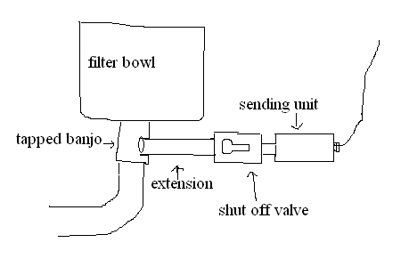

i have a tapped banjo bolt that goes into the bottom of the filter. i used a small plumbing extension, shutoff valve, and screwed the sending unit into that.

My first (and only) experience with electric fuel presure gauges on a CTD is this....the needle tends to vibrate a lot!
I'd be more prone to mount it away from the filter (which is mounted on the block). Post filter is smart....I prefer mid line, between the filter and the VP-44. JMO.

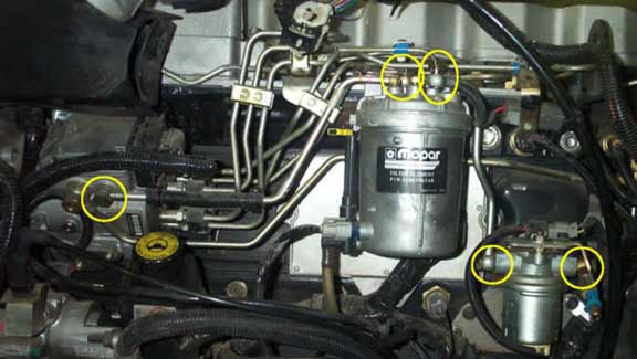

RowJ, would you just remove the line from the filter to the VP shown in the pic. cut 3-4" out, put a brass T in with rubber line connecting it all together w/ 4 or 6 clamps and mount the sender to that? and can i get new washers from Dodge or would i have to order banjo bolts along w/ them? and what are the torque specs on these two banjo bolts?
and Lotero, where did you get this tapped banjo bolt that you speak of?
Thanks guys!

Old Oct 17, 2007 | 04:49 PM
RowJ's Avatar
Joined: Apr 2004
Posts: 8,234
From: Texas/Oklahoma Border
Been 4 yrs since I had a Dodge fuel filter but yes! Cut the line half way (rubber line already there....no?) and install a T.
I might also replace the hard line with a 'big line' Kit for better lift pump protection... but that can come later.
I don't remember the fuel line coming off the top of the filter...... think mind came off the bottom??
RJ

alright, Cool! thanks man! Yeah, now that you mention it, mine does too. i just went onto google and searched for "tapped banjo bolts" and that picture came up so i used it on here. must be a 12V or something. i do believe that's what i'll do.
