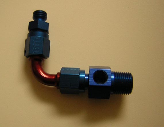

Does FASS come with fuel lines or uses stock fuel lines?
I put this together for my system... No idea what kind of pressure it'll give me or HP it'll support.
This is 12mm x 1.5mm weber carb (vp44) to -6an adapter, -6 an female 90 degree -6an female, -6an male to 3/8" npt male with 1/8" npt fuel pressure gauge port
I'll be running 3/8" SAE J03R9. Wonder if I should've gone with 1/2". It'd seem weird running 1/2" when the port on the vp44 is so small. But I guess if the bottleneck is RIGHT at the vp44 it doesn't matter much(?)
In terms of bleeding the system - I agree with running the pump all the way up to the vp44, then plug 'er in and see what happens. Bleed injectors as necessary.
