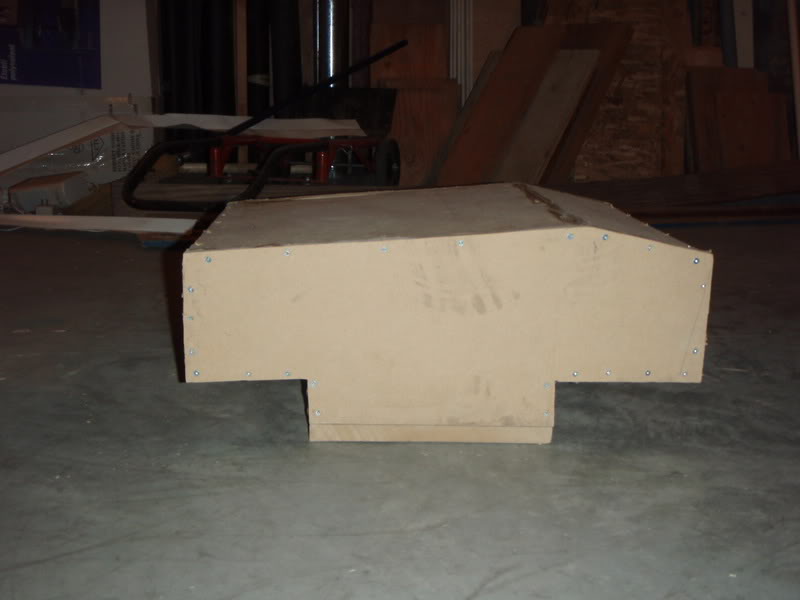

I did just what you are looking for. Can't remember the exact dimensions, but if you're skilled enough to build your own box I'm sure you're compitent enough to take your own measurements. Fits in like factory now!

Ahhh very nice, and the seat still looks useable too. I actually dont care if the seat is useable or not. how much airspace were you able to get out of your box? And to respond to gotstacks, the rear seats are packed with 2 amps, audio control matrix and the carputer.
Old Mar 17, 2009 | 12:49 AM
Kiff's Avatar
Posts: 42
From: Vancouver Island, BC
I think I did a rough calc aroun 1.2 cuft. I put a bunch of insulation in it to take up some space because the alpine Type R I have in there wants 0.8 cuft. If I were to do it again I would make the sides a little smaller so it sits down flush with the rest of the seats, but as it is, there is still good padding ontop of the box. Had a girl sitting in the middle on a 5hr trip and had no complaints, she liked the bass though

do you have the subs face sitting directly on the floor?

I would assume its probably about an 1" or 2 off the floor.

so would i just looking at it though it looks that its flush with the floor.

it's sitting 2" off the floor because the sub moves out 1.5" at full power.

that looks very nice i have been trying to figure out how to build it is that for a 12" or 10"?
