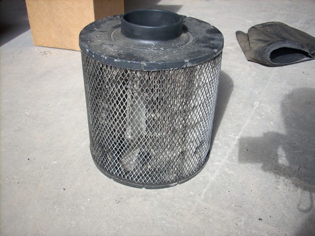

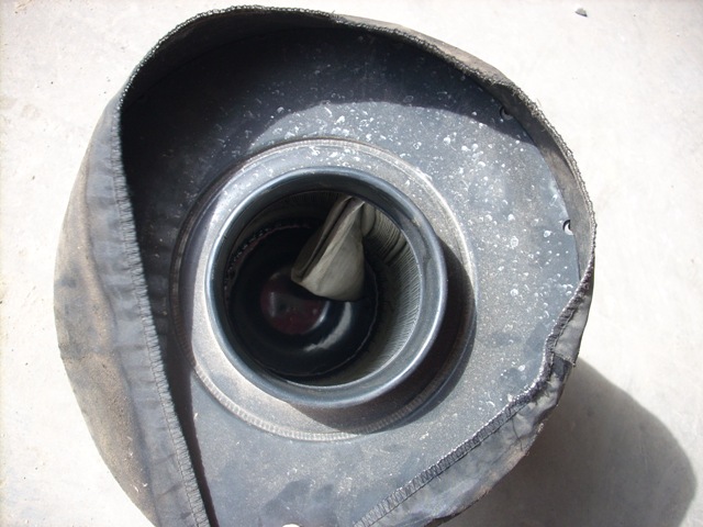

I have had some problems with my boost system for the last few months that I could not figure out. Basically, whenever the truck needed lots of boost like when passing someone on a 2 lane road, the truck would lose power completely. I could not figure out the problem; I had checked the boots, turbo, MAP,etc. Well I changed my BHAF the other day at 35K miles (168K on truck), and as soon as I saw the inside, I knew I had discovered the problem. The truck runs much better now.
This filter was 10 months old / 35K miles; my “boost problems” first occurred at about 4 months into the filter. Note how the inside of the filter is separated….man these trucks can suck some air! This filter had the outerwears and washed it about every 6 months, but I never checked the inside of the filter when pulling it off for the oil changes.
This was a NAPA 2970 filter...Check your filters regularly!

Thats the first ive see that. I ran a few of them on my trucks and never did that. I had one on my 99 for a while running 45- 50 psi boost and it stayed in tached. Did you mabey get it wet somehow, i can see it getting messed up that way?

The BHAF had a outerwears on it; the filter should not have been exposed to water other than normal driving conditions. I first noticed my “boost problem” or lack of air intake about 3 months into the filter or roughly 12,000 miles; the problem got progressively worse to the point where the filter should have been changed at about 18,000miles, but I did not investigate the filter because I knew it was probably only at about 50% lifespan. My first to filters lasted 40K easily, only changed as a precaution.
We change our OTR Heavy Haul truck filters at 300 hours; I will begin doing the same as the $50 preventative maintenance is well worth eliminating the truck depression I have gone through over the last 6 months (not to mention I almost spent a grand on a new turbo!). Remember the fundamentals when investigating any problems! I will continue using the BHAF, but more cautiously; I just don’t like the oil in the other options.
