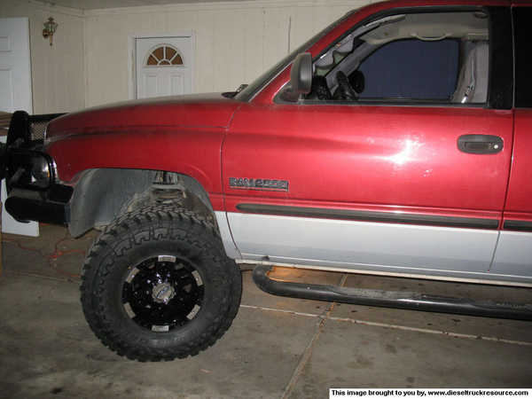

Heres mine with 2" leveling in front, but also did 1" or 1.5" block in back to keep the rear up/proper stance.

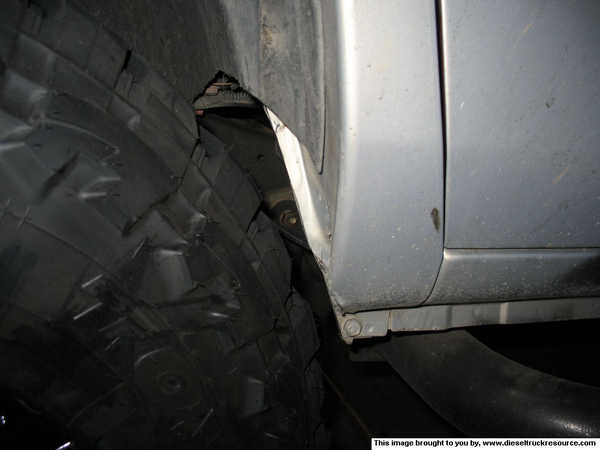

One thing to consider is clearance. I know everyone says 35"s clear just fine.. but with a simple ranchhand on the front 35"s would not clear on my truck.. maybe somethings whacked on the front end (although tireshop says everything is fine):
I had to cut away a bunch of the fender... and since then they still hit when offroading so i trimmed it back about another 2" further than this picture. This was just to get the tires to stop rubbing while turning into driveways.
