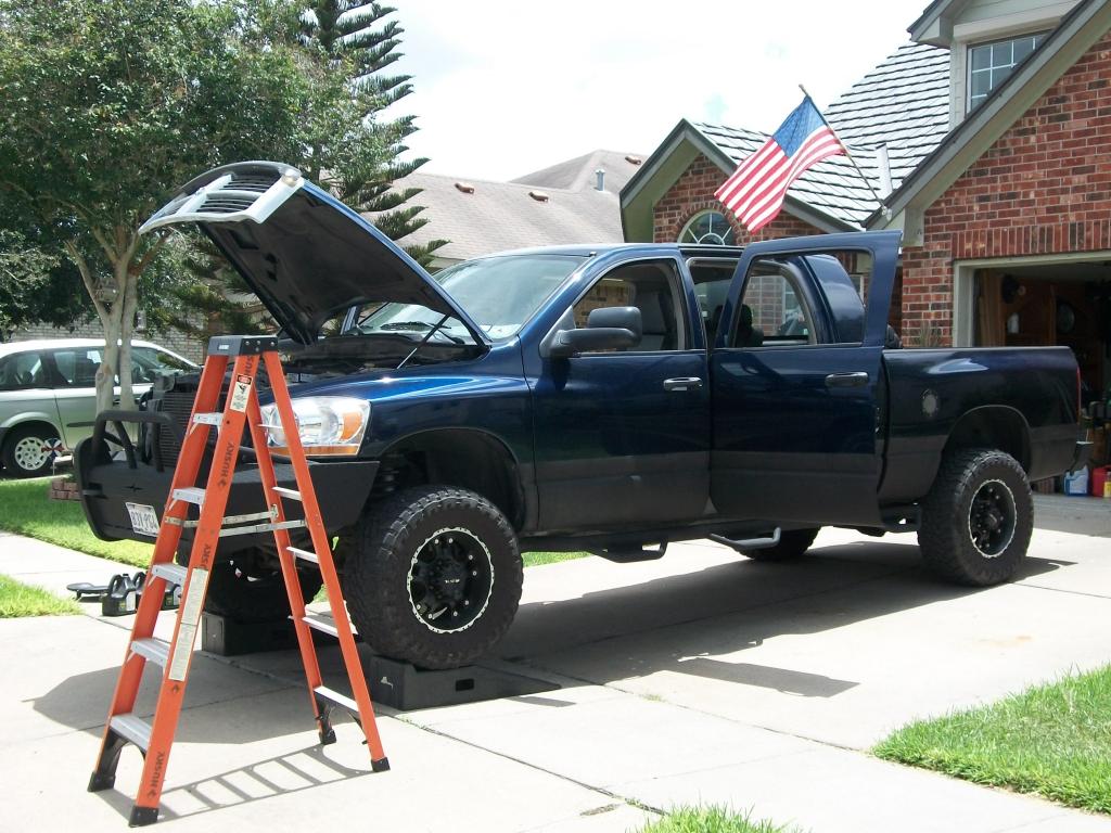

I use 2x12's... it works pretty good. It's an old pic...

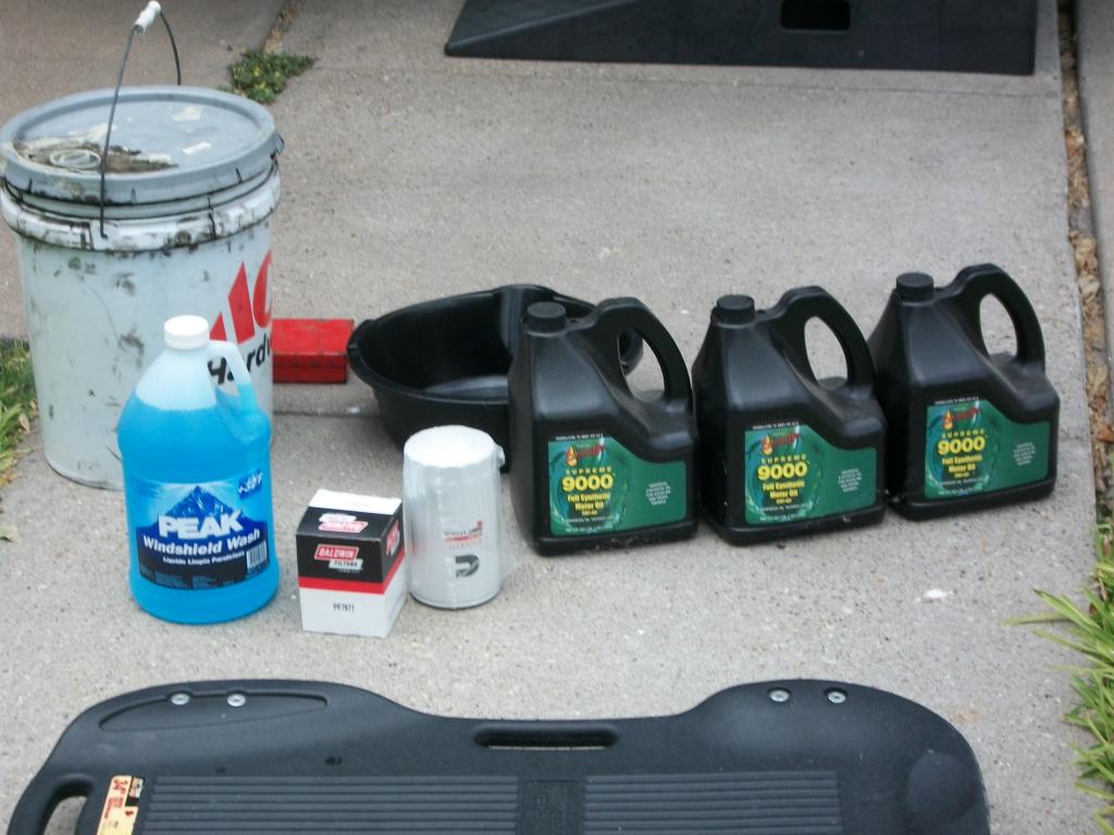

Sorry for bringing back an older thread, but I just did my oil change and fuel filter today, and this is how I go about it in my driveway. Always make sure you have plenty of beer before you start, because once you start, and find out you're out of beer, there's no going to the store to get any! Oh, and yes, a ladder is needed in this situation! And Sirius sat radio is set on Outlaw Country channel!
Attached Thumbnails Sloped driveway - can I build ramps to level??-004.jpg   Sloped driveway - can I build ramps to level??-005.jpg   Sloped driveway - can I build ramps to level??-003.jpg
