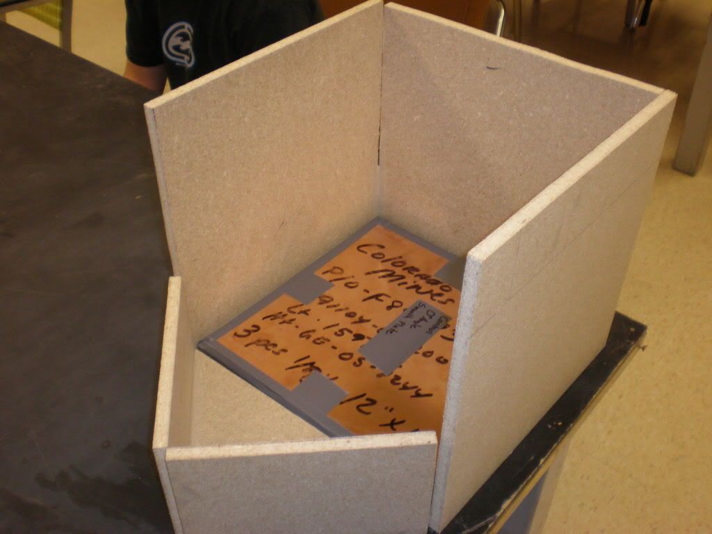

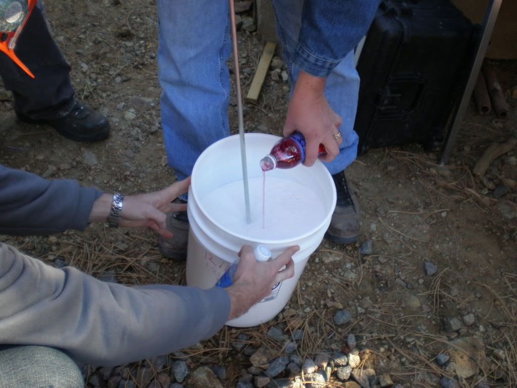

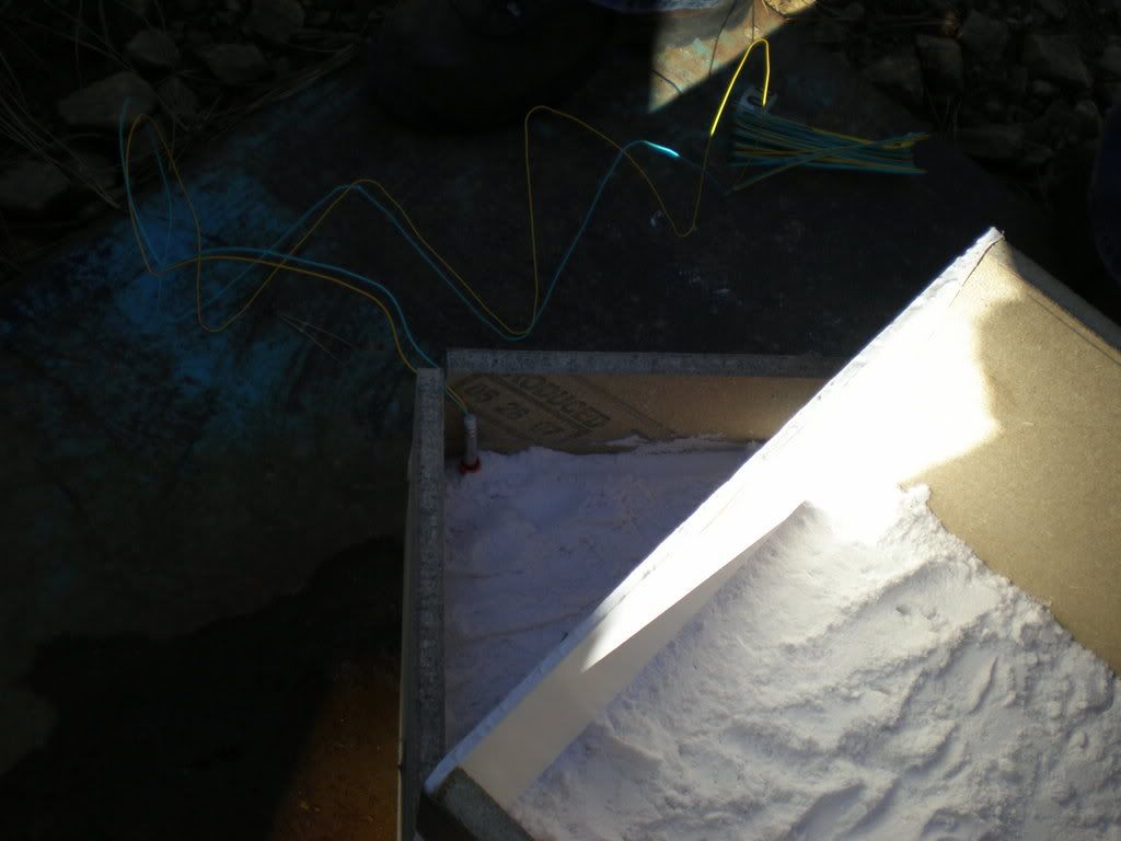

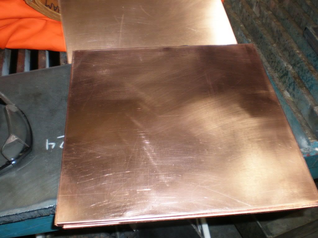

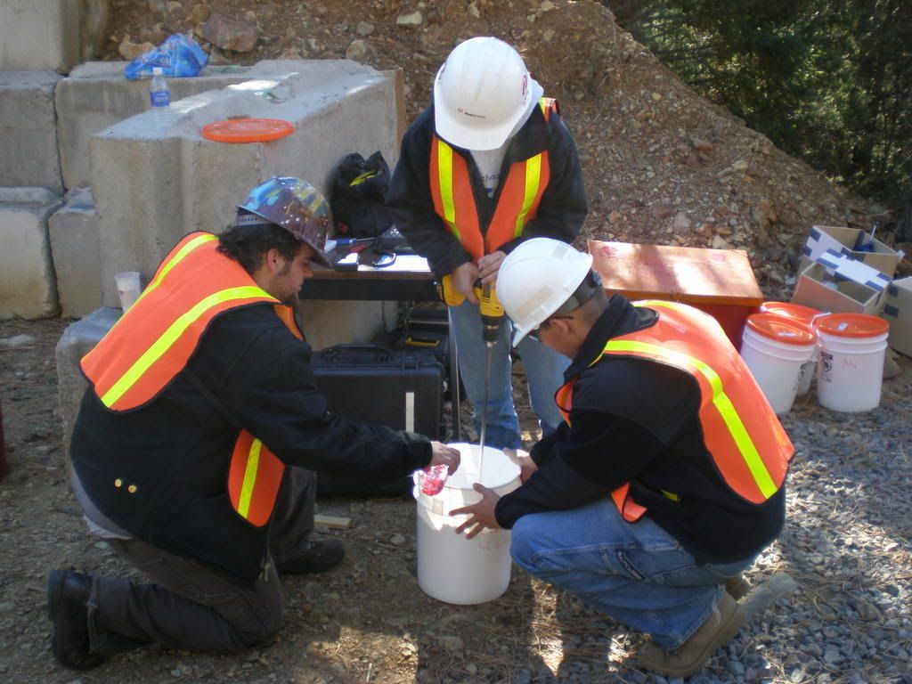

Well, today we blasted the plates! If you happen to be in or near Idaho Springs, CO, that was us making booms. Used 14lbs of ANFO per 12x12 plate. All our different tests bonded successfully, now comes sectioning all the plates. Should be some good waves. Well, to the good part, pics and....a MOVIE!
Copper plate
Box that holds ANFO on plates:
The team, putting the FO and ANFO!
Our best friend, that's no fruit punch, good ol' number 1 diesel
The setup before sand on top for containment

I imagine it's close, this is considered solid state though, no melting, just really high pressures, the metals act like fluids, but don't melt at all.

Were trying to join dissimilar materials, the copper and steel, just two flat plates being slammed into each other. The waves look just like real waves breaking, just little waves of Cu in the steel, I'll get some more of that once we cut and polish.
