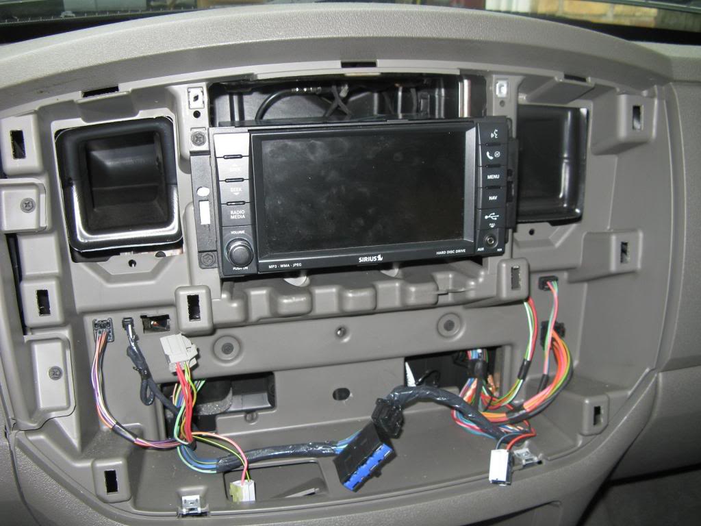

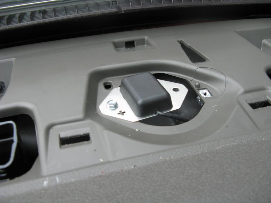

Finally got around to finishing up my bezel and had the time to install it all today...
Pretty straight foward, MyGig nav radio(has to be low speed) and the lockpick adapter harness from coastaletech, and lastly a factory navigation bezel with added trim pieces for the gap top/bottom....
Here are the pics...

The lockpick harness also unlocks nav while in motion, dvd playback in motion and also has an internal hard drive for music and pictures...
I know my bezel isnt great either, but its all I had on short notice and its good enough for me
