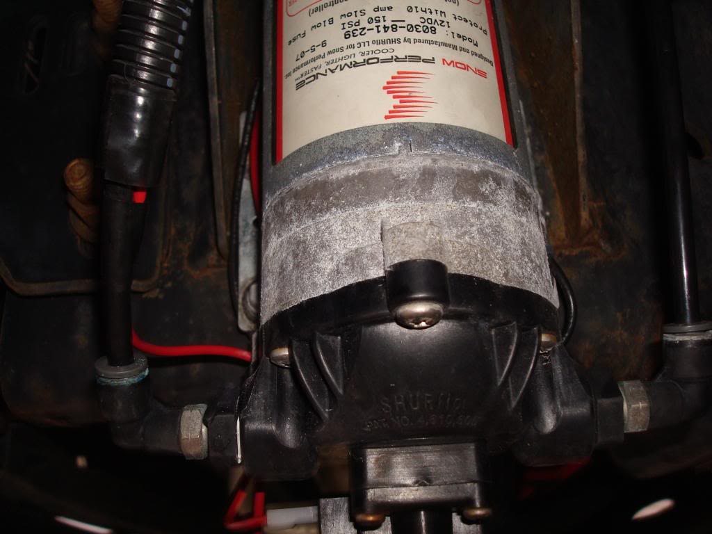

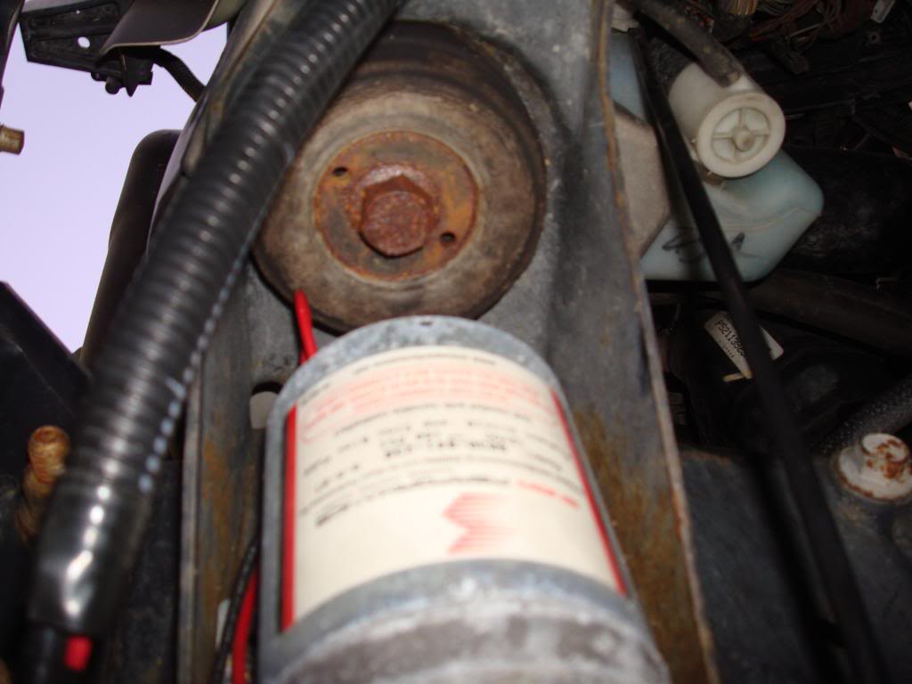

I mounted mine on the front of my frame... I don't have any good pics, these are the only ones I have. If you want better ones, let me know...

I mounted mine real close to where he has his, actually on the side of that body mount bracket, got three self tappers in there and all is good, new style and old style pump fits no problem, ans I had the old, and now have the new. boy does the new flow a lot more than the old pump.
