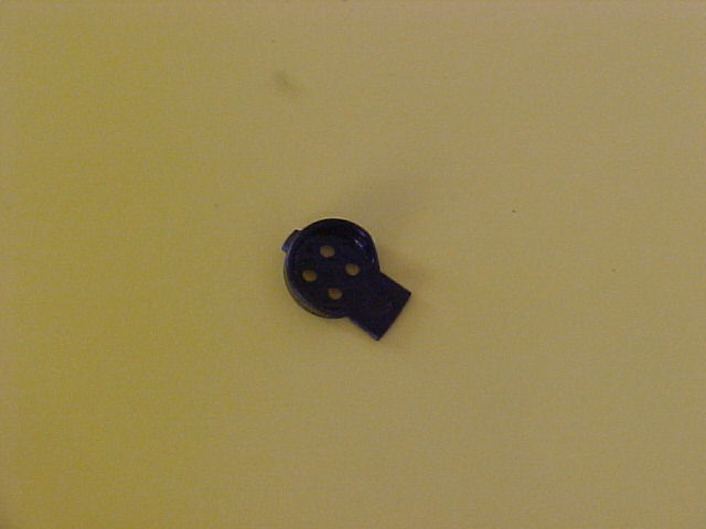

That's right, mine has the kickdown band on the front, maybe yours is different. I found the wedgy thingy in the pan, I am installing it back into place. Seems to tighten up correctly.

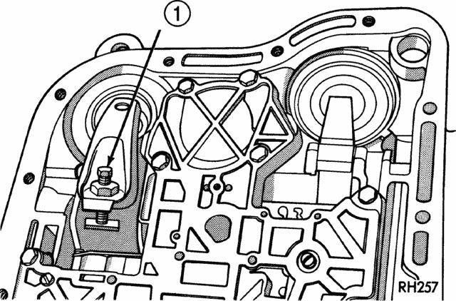

There is another band in the back of the trans as well. Have to have the pan off to get to it. Near the back ov the valve body, obviously inside the pan rail. Do it before you put the pan back on!

I found a plastic piece in pan, I will try and upload a picure.

Here is a pic of the rear band adjustment.
