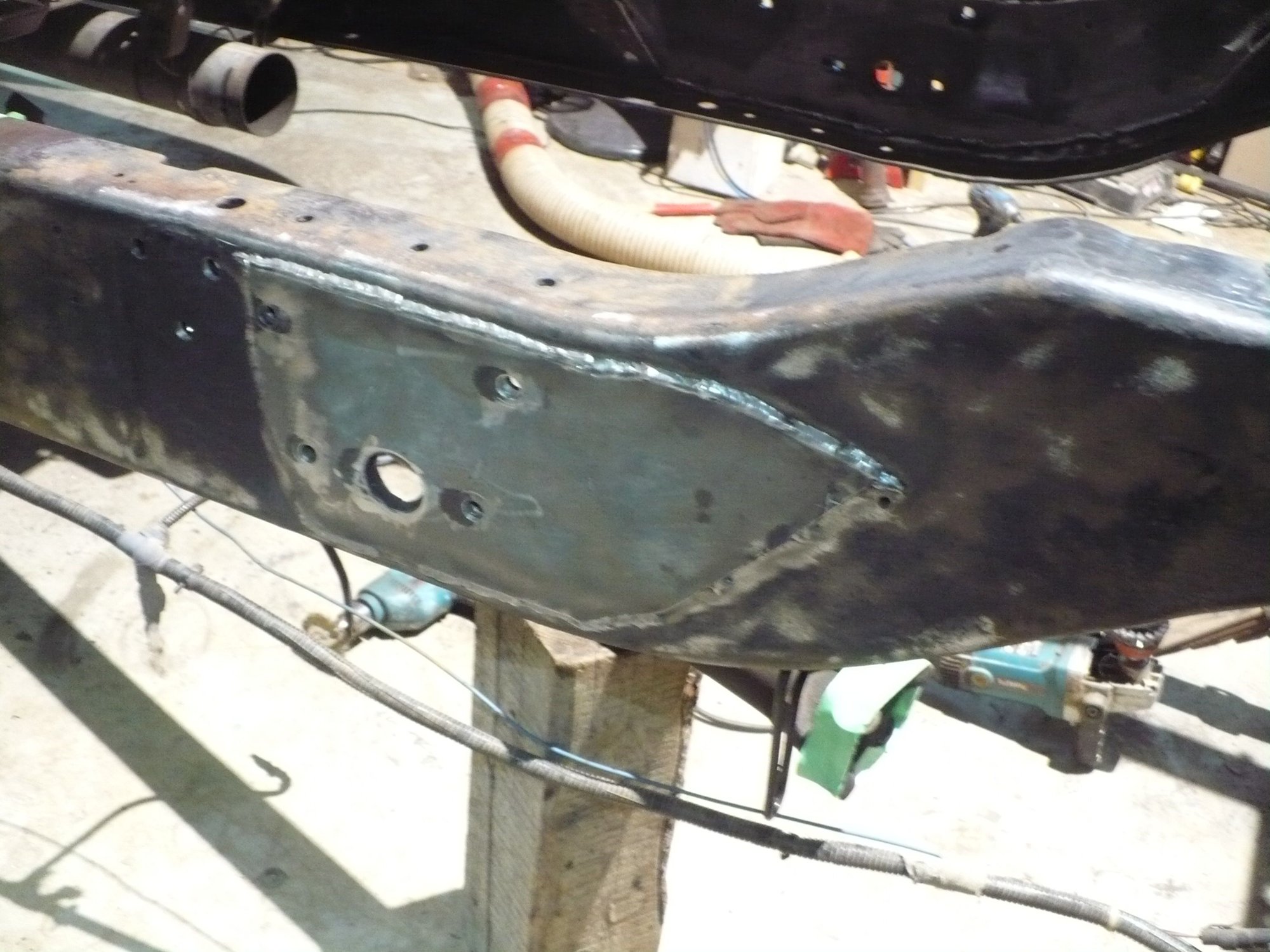

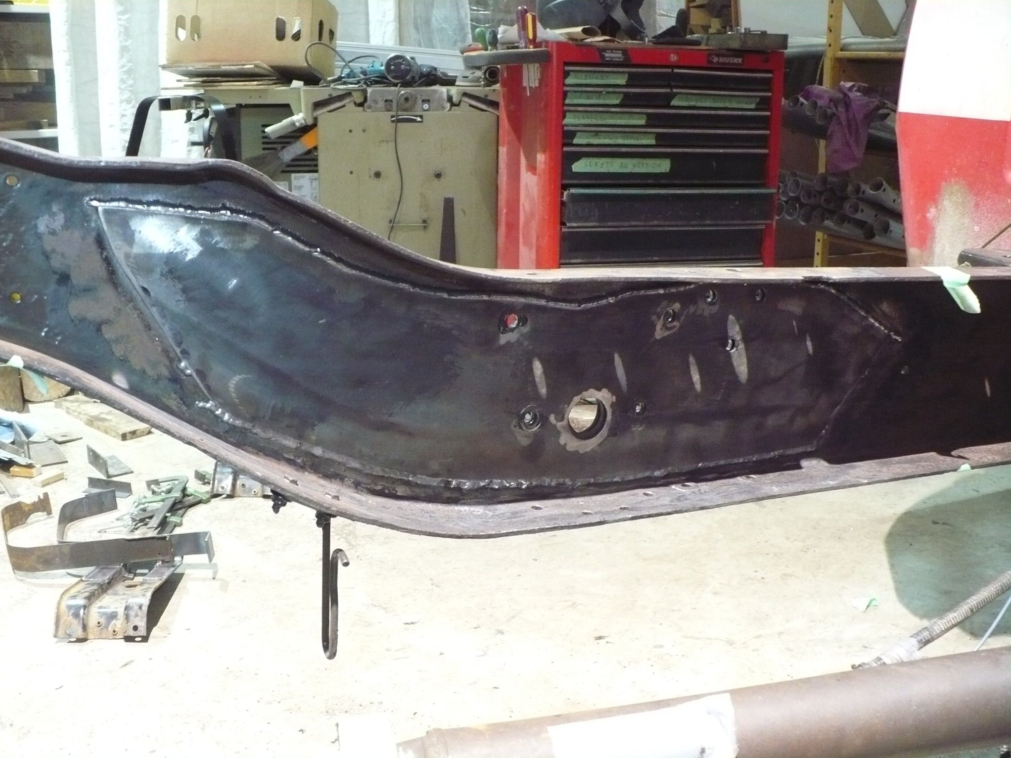

I am looking for opinions on how I should weld my frame on my 93 W-250. I am on a bit of time crunch finishing up and by the end of the week it needs to be on the road and I hope to get it welded in the next 2 days. I was preparing to swap my leaf spring mounts when I found that underneath both my front of rear spring mounts there was serious rust damage the side with the diesel tank was much worse. The flanges or top and bottom of the frame are in good condition and it seems like the serious damage is localized the frame surrounding the rusted out section is thinner forsure but there is still some material, particualry around the top two bolt holes. I have a set of hangers I am going to instal but I am not comfortable welding this job myself so have prepped the truck removed all the hangers etc and plan to pay someone to weld it, can update with pictures of the prep work I have done tomorrow.
In my search I have gotten very different quotes for the job and techniques one person who specializes in higher end automotive repair suggested removing the rusted out area welding a new piece in then sandwiching it with a plate on either side this is obviously complicated as the holes in the new piece will need to match the bolt pattern for the new hangers I got, they quoted me $1000 for the job if i did all prep and clean up, grinding welds etc. Another person who is heavy equipment welder suggested just putting two 1/4" or 3/16" (no wider) plates sandwiching the rusted area on either side welding those sealed, this would mean you could just re drill out the old holes and they quoted me 400$. This person suggested cutting the frame was a bad idea as it would stress the metal opening the door for problems in the future and more importantly the steel inserted in place of the cut out section would not have the same characteristics as the steel of the frame which is intended to have some flexibility and this junction could be problematic, while they were open to inserting in a new section they suggested sandwiching was a better option.
What are yalls thoughts? For some context this truck is a work truck it dosent have to be pretty it will be towing occasionally but more often hauling firewood, building supplies and random junk in the bed.

Thanks for input but ended up getting the welding done yesterday before seeing your post a friend ended up helping out. Moving the hangers all together would have been a good idea though new leafs would be a little out of the budget.
Ended up reading that using thick steel isnt necessarily good as from my limited understanding you want to use stuff the same thickness or thinner than the existing frame, hopefully thats right ahaha. Ended up cutting two 1/8" plates for each hanger positioning and sandwiching each side then welding them up, didnt remove any parts of the frame. My friend who was welding suggested a solid weld around the whole plate would unnecessarily stress the existing frame and so left two areas of each plate with just tack welds. I will be sealing it using steel seam sealer.
