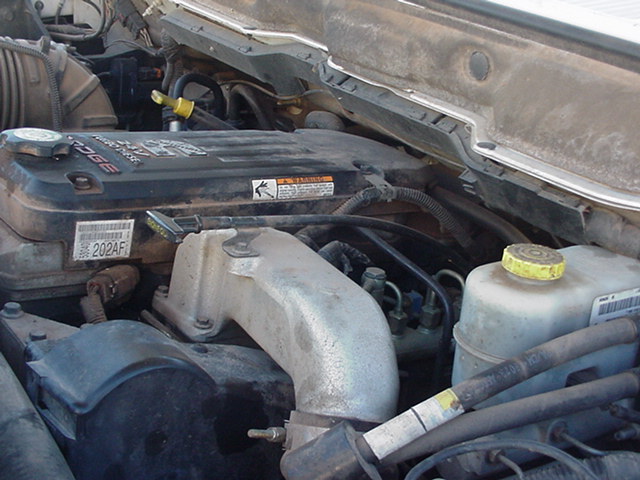

So both of these trucks have common rail motors? If that is true than they are both '03 or higher model year trucks. Unless some one put an '03 motor into an '02 truck. Can you get pictures of the engine compartments to post on here? Most likely it is a lift pump or an injector problem as others have said. Maybe even a CP3(injection pump) on it's way out.

Yes I have a picture of both engine compartments
Edited to add: From the build dates shown I would assume that they are both '03 year trucks.
yes they both are rail type systems. the injectors all come off of one rail. if you crack one line and I have it will kill the engine if you are not fast. I will upload the pictures of one or both if you would like when I figure out how. The 03 was bought new it is a dulley 4x4 auto. the 02 is a 2500 cab & Chassis bought with 35000 miles on it. it is a 5 speed, 4x4. The 02 has a very slight miss at throttle most people would not notice it. I suspect that it has had water in it and it has gotten an injector tip or injector.
