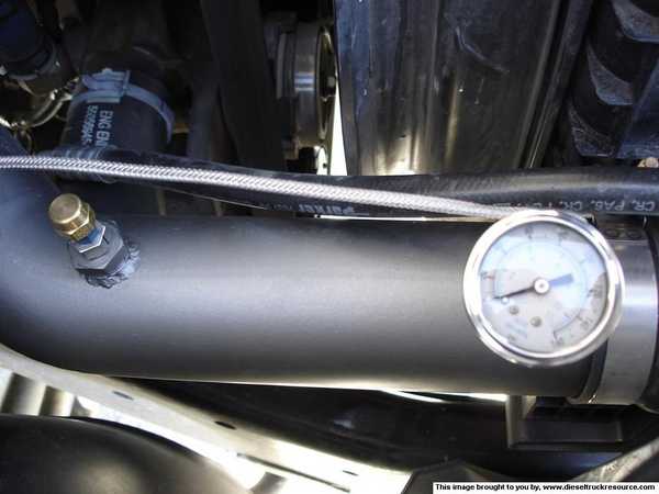

The differential is measured between the outside ambient air temperature at the driver's side of the charge-air cooler, and in the center of the intake manifold air horn just above the grid heaters. There is another pyro mounted just ahead of the intercooler in the pre-CAC ducting, but I don't have enough data to report from that sampling point yet:
The pyro probe is just behind the boost gauge.
The intake and exhaust have been heavily modified for maximum flow within the stock sheetmetal envelope (i.e. no stack through the bed, hood scoops, etc.). The exhaust is comprised of an Aeroturbine welded to the downpipe, followed by the cat-shell, which has a 65 degree downturn welded on the end.
Soot exits at the rear of the cab, underneath the H2O/meth injection pump.
As for the intake, this picture sums it up best:
Normal driving yields about a 5-10 degree F differential (in any temperature), while WOT (stock fueling) results in as much as 25*F differential before running out of road or RPM. On the dyno, delta differential is much faster than the street, since there's no airflow to speak of to delay the onset of heat soak. Of course, these values correspond to 32 psi max boost, so later this spring we'll have the data for boost in the 45 psi range.
