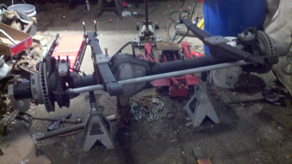

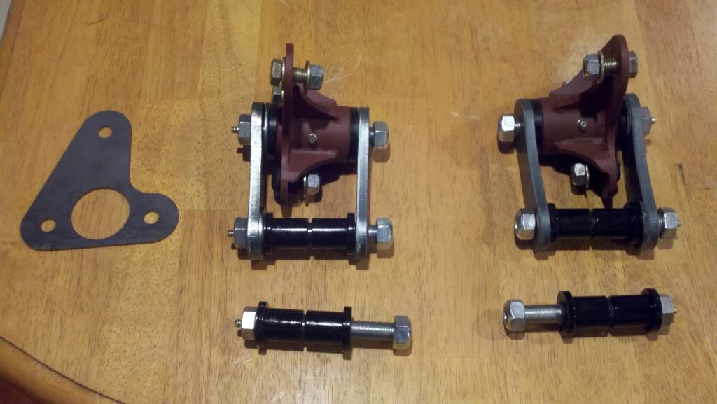

And here are a few of some of the parts before they went in:
