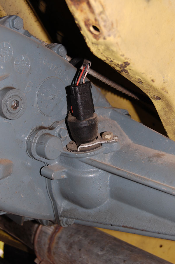

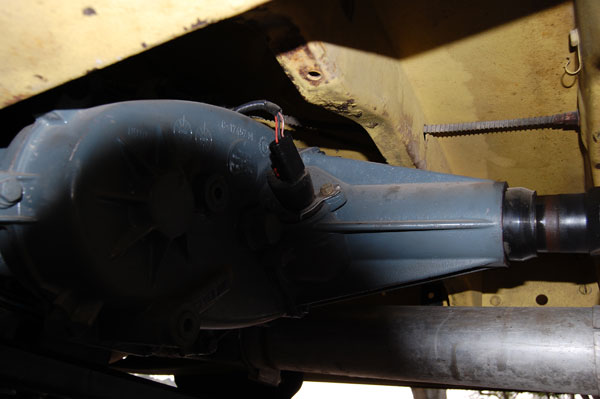

Finally got under the truck today to take a picture. Not sure where AutoWorld found this. My first suspicion is that this didn't get put back together right.
Peter

Well, that's not a 271 or 273 transfer case. Looks like a 241 maybe (out of a 2nd gen dodge)... Regardless, that's the sensor they would be using for the signal. Check your connections where the tranny shop would have disconnected it...
