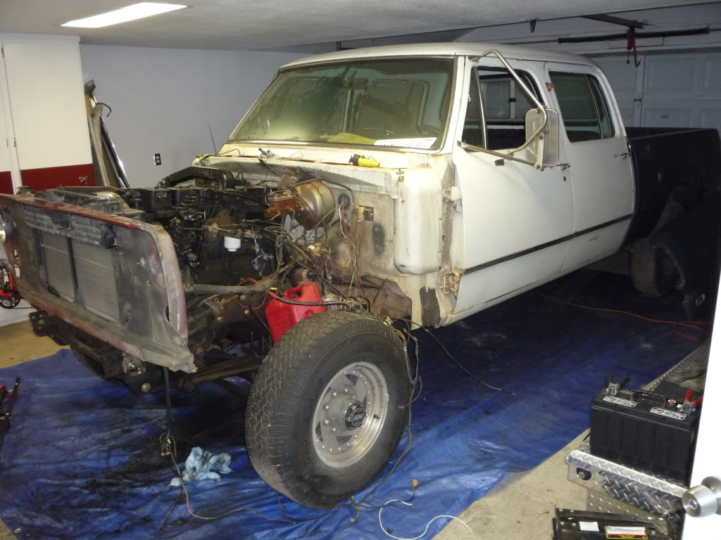

The latest is the cummins is in the truck... need to replace a rear cab mount and config pwr steering, brakes, and fuel...
Rebuilt the whole front end with 1992 pieces... front and engine xmembers, front spring eyelets... (beefier than the 1972 ones that were CRACKED)
Added a 6th leaf to the stock military wrap packs on there.. looks slightly positive with all drivetrain installed...
Engine starts and runs though, good to go.

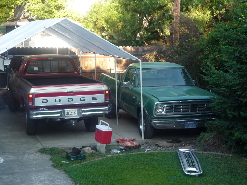

Yes it is a clean truck! It needs a pinion bearing in the rear axle though. And it needed to still be smogged in CA...
The 1976 bed, and front clip is going on the crew.
Everyone loves that clean little 1976 D100 Truck, not sure why haha...
The drivetrain will serve someone good as well, with a clean low miles engine and trans like that.
Truck is sorta getting done... drove it yesterday and today... Not a resto, just an engine transplant, really.

drove the truck a couple hundred miles today in the mountains to loon lake, it ran out great. In OD on the brownie with 4:10 and 37" hmmvw tires the speedo was reading 25 mph slow!!! wow... I think I need to get an alignment, it twitches and jerks when turning left... otherwise I was able to cruise at 70 all day long.. earplugs a must for long rides though at this point. I need to trim the fenders a bit more as well... flexed it out a bit much today and found that one out quick lol. pics and vids were taken if anyone is intersted.
Is that really how the mirrors mount? Looks crazy? I have never noticed them like that but will be looking around to see a older Dodge to compare with? My 2004.5 is the 1st Dodge truck for me so the older ones I know nothing about.
nah, they are installed incorrectly (intentionally) by the PO. They're designed to come straight out and the bar that the mirror sits on is supposed to be perpendicular to the ground. (huge towing mirrors) I don't know how they figured it out to install them this way but I have a pair of doors, front clip and bed from my 1976 adventurer that will be going on there soon.
